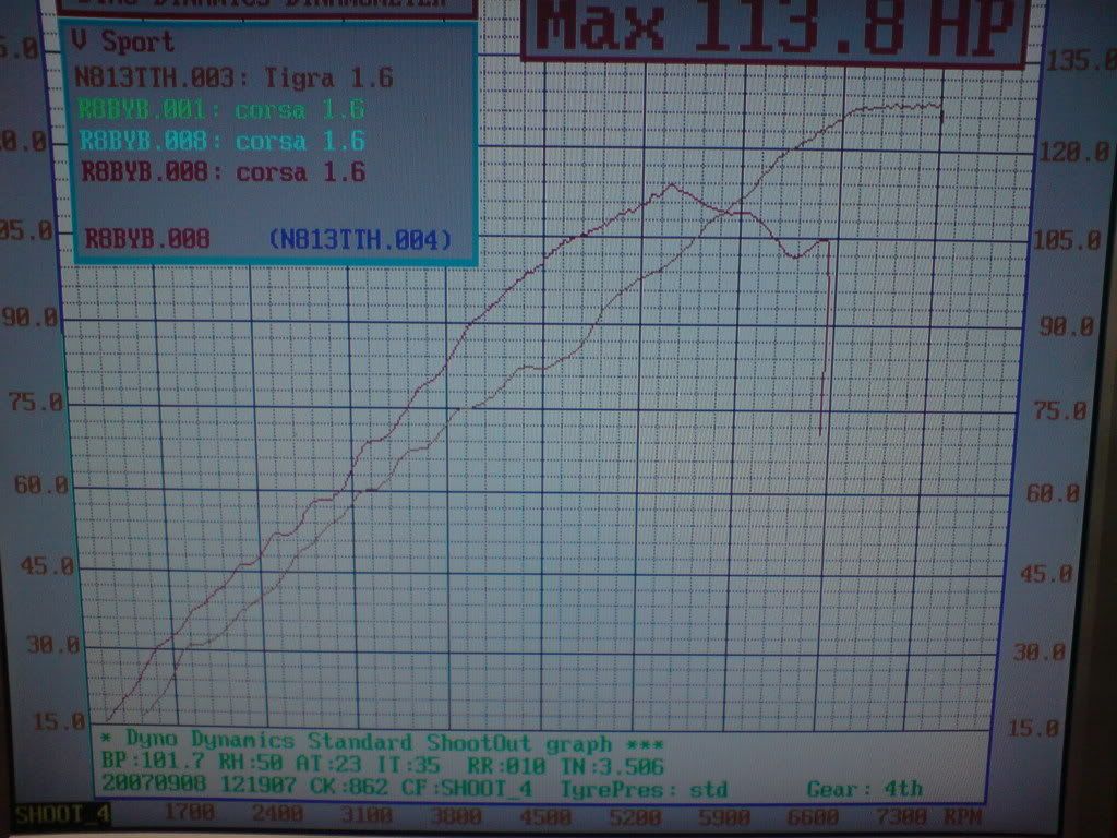

so you have a choice of 2 identical engines.
engine 1 is a 1.6 16v engine that makes 113 bhp
engine 2 is also a 1.6 16v engine that makes 129 bhp
95% of people would take option 2. personally I would take option 1:
Both X16xe engines. the engine with less peak power makes 17 bhp more than the other one at 4500 rpm! but then loses out from 5500 onwards due to inlet design. engine 1 also makes about 15ft/lb more torque from 2200 rpm to 6000 rpm.
Peak power figures are irrelevant, its what happens between 1000rpm and peak rpm that counts. Which is why V-tech is poo

28th Mar 08 at 20:51   View Garage View User's Profile U2U Member Reply With Quote
Do you mean you would take the engine with the lower peak power figure?
You're quite right about having it available to you, the less powerful engine is better all the way up to 5900 which is plenty.
What is the difference in spec on those engines?
yes, the one with lower peak power is a much better road engine. engine with less peak BHP is a completely standard 1.6 with the long black plastic inlet tubing removed with a filter coming directly off the TB, the other is a completely standard 1.6 with a dbilas inlet.
Bothe engines have identical exhaust systems that I built.
28th Mar 08 at 20:57   View Garage View User's Profile U2U Member Reply With Quote
So the dbilas inlet has just shifted all the power up the top end to the detriment of elsewhere in the rev range basically?
Unless those mods listed to the first engine are doing much? Not sure myself?

This is the over lap of my engine, before and after my Mantzel. My mate who has that C2 VTS said that it was quicker before hand......
You can see that at 4300 the BHP and lbft were more before.

Is the torque line with the mantzel fitted the lighter red/purple one on that graph? /\

to be honest, I'd like to see the torque as well on the graphs...
by the looks of it, it looks like the high peak bhp engine makes a little less torque but continues it further up the rev range...
On the road I reckon the 129 bhp car will still be quicker.
It can be left in the lower gears for longer (while it still is effective, i.e. power rising)...
The 113 bhp one, would be changing gear about 5200 rpm...
the 129 bhp will change gear around 7300 rpm...
So on the road, in a little race, while the 129 bhp car is in 2nd gear (easier to turn gear) it could probably accelerate to past 60 mph.. still in 2nd gear
The other car would probably have to shift to 3rd (harder to turn gear) a lot earlier ...
Basically what I'm saying is on the road in a little race, the 129 bhp car would probably seem to accelerate quicker...
but on say 1/4 mile - I doubt they'd be much in it.

Dave-Do you have a torque graph for those first 2 engines? Because i know with my before and after graphs with the inlet box fitted, my engine made the same PEAK torque, but the graph was pretty much horizontal. Whereas on the std inlet the torque was low, then peaked, and then back low again in a curve.....
