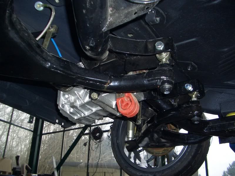

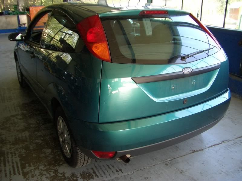

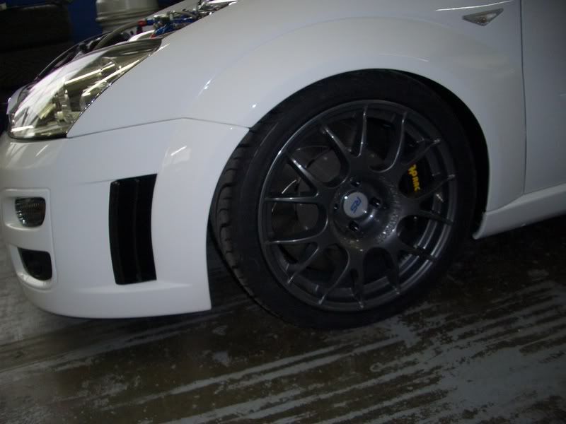

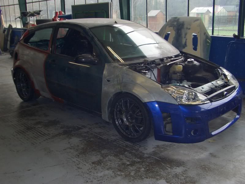

[quote="TurboGuido"]ok, here a few pics from my Project, beginning was November 2006,
and was start all with this 100bhp standart Focus :top:
the car for needet welding Parts like floorpan......
after 2 days all striped
Engine in for testing
the first Focus RS parts arrived
ready for the FRS wheel arches
new wheels
thw wiring, what a nightmare
ready for paintshop

quote="TurboGuido"]new brakes arrived
front 378 6 Piston rear 330 4 Piston AP Racing
