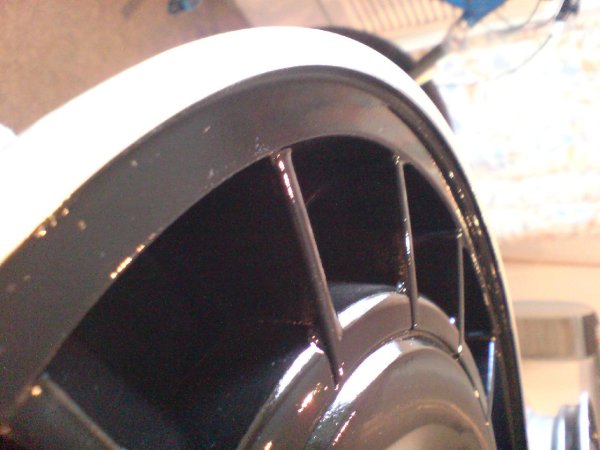

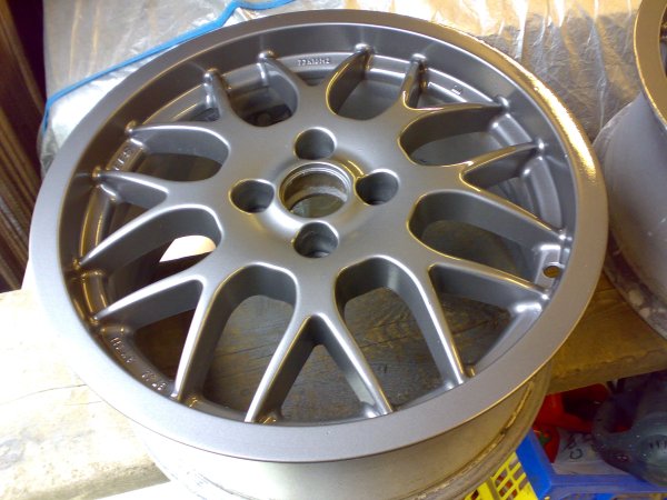

i painted these
and
both in vaux anthracite
[Edited on 25-01-2008 by bieransri]

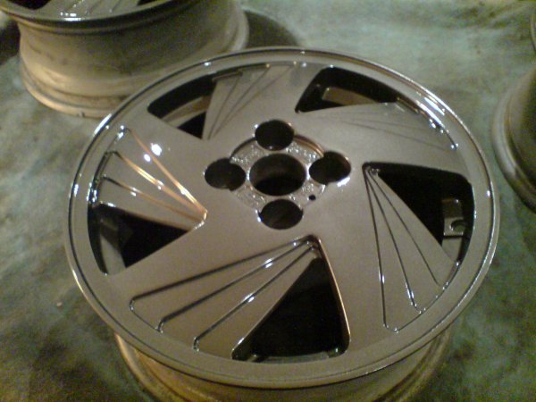

i pained theres with cans
[Edited on 25-01-2008 by GSi_16v]
16V_1600
Registered: 7th Oct 07
25th Jan 08 at 21:11   View User's Profile U2U Member Reply With Quote
Can't wait to finsh my Cav Gsi rims in black. Can get a proper pro finish with rattle cans. All in the prep
Nick-S
Registered: 3rd Mar 04
25th Jan 08 at 21:17   View User's Profile U2U Member Reply With Quote
i was lazy with the prep and i dint use primer
i just got lucky

Done mine with halfords rattle cans. managed to get a pretty good finish too
