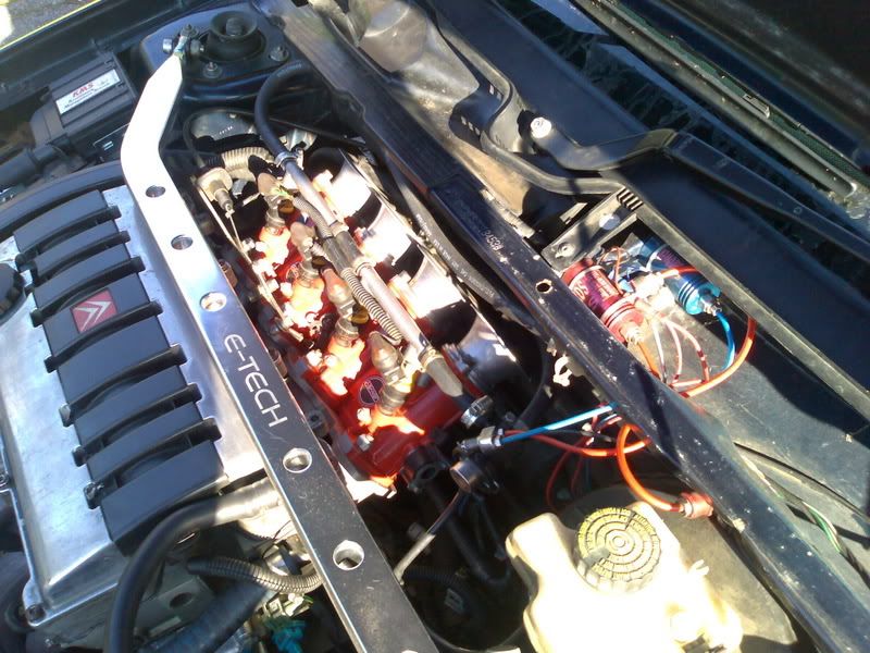

Means i need to use their injector and metering jets too. Not using their bottle though, thats going to be a ny t-rex one (with -4AN to 5mm adapter so i can use WON nylon lines)
Should look like this...

Originally posted by Superlite Ltd.
WON bits it is then
that isnt yours is it ed?

Nope, that is another green 2.0 8v but with an extra 75-100bhp (depending on battole temp) of N2O

i'd be tempted to have the kets more angled towards the inlet otherwise you could end up with nos going one way and the fuel not getting there as quick. Also want to keep your lines as short as possible so possible go straight through the bulk head, trying to fing a pic now of m=ine
