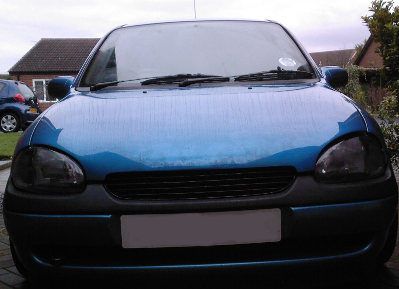

tried adjusting it loads of times but it just doesn't sit right. Starting to think it's the bonnet that's knackered.
Opinions?
ta
pow

Bonnet looks fine to me, headlight on the otherhand,

cheers, does the passenger light look ok? Just the drivers side light appears to have sunk?
They are brand new depos fitted so all the brackets are intact. Really wanna sort it out, but not sure how

you adjusted the rubber bits under the bonnet?

Adjust those rubber bits down a bit, and then there is something wrong with that headlight.

that pic is without the rubber stoppers.

looks to me like passenger light isnt on properly

both lights are bolted on and fit ok, but I can slide a finger between the bonnet and the top of the headlight on the drivers side
Wonder if I am missing some kind of seating bracket?

Little white clips? They cost about 39p from Vaux and hold the headlights up!

what he said ^^^
they brake easily taking old lights out

looks more than just a clip to me...
bent panel behind the bumper?..
that headlights set very far back.

think they are missing
Everything seems straight to me and the car is HPi clear.
You'll get change from £1 for them
