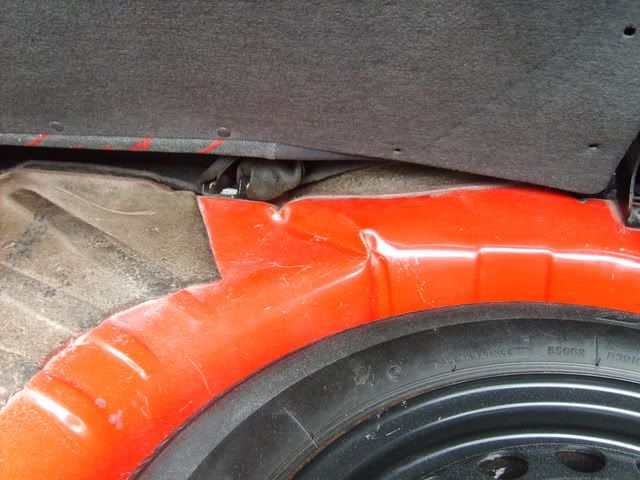

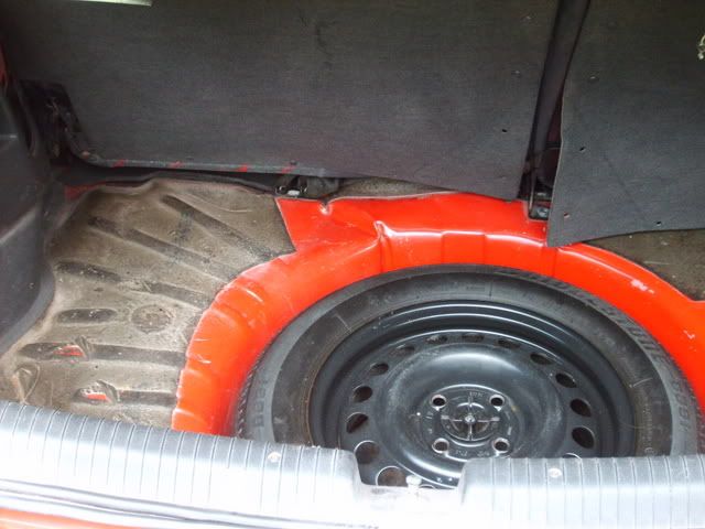

I just spent the last few months re-building the GSi spent a crap load of money finding parts for it as they are bloody hard to find over here in Oz......
FAILED Roadworthy / MOT
Reasons : Airbag light fails to illuminate ...(can be fixed)
ABS light fails to illuminate ....(can be fixed)
Wheel bearings need adjusting .......(can be fixed)
Vehicle body unsafe for roaduse .......(CAN'T BE FIXED)
Some of you might remember the damage to the rear of the car and the big job it was to repair, the spare wheel well is starting to fold in on itself making it unsafe for roaduse.

MDF False Floor over the top, or cut it out and weld a new bit in!

Fuck covering that, weld a new bit in

I've found a smashed 1995 model at a wreckers so I'll cut that section out and weld it in. It's a massive pain in the arse.

Take airbag lights out of dash....
Also, re the shell, try this.... Excuse the sound matting...
Have the spare wheel arch removed/cut out. A plate welded in over the top. I've got one plate below the shell and one inside the car. Been welded in and sealed, then the underside undersealed.

And the rules may be different in Aus, but in the UK its not a requirement to have a spare wheel.
Spare wheel arch removal is a fairly simple job for a bodyshop. As long as its sealed, and the brake compensator has a new bracket made up.

UPDATE:
Previous owner had the car inspected by this tester previously. He knocked it back then due to previous owner being an idiot and assumed it was still owned by the same person.
I will be soothing the damaged area with fibre filler, then a quick application of body filler, then a quick blow over with some 2 pack that I have left over from previous spray job....and then to a different tester that I have just been told will pass it as long as all the usual things work (seatbelts, indicators, headlights ect..) so we will see what happens Thursday.
