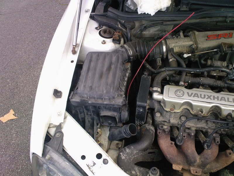

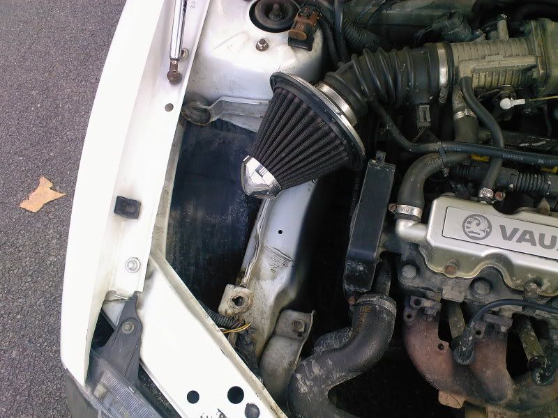

Had an attempt today, but am a bit confused with some of the connections, they are different to Haimsey's.
Old filter:

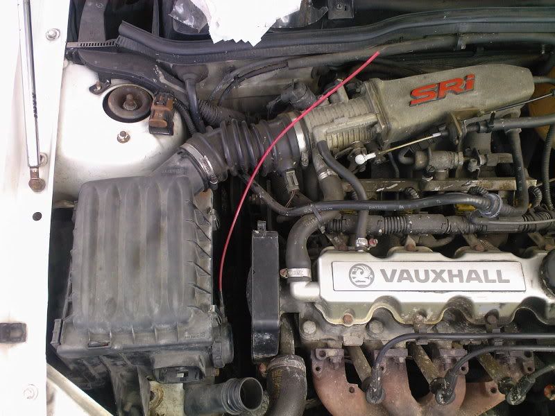

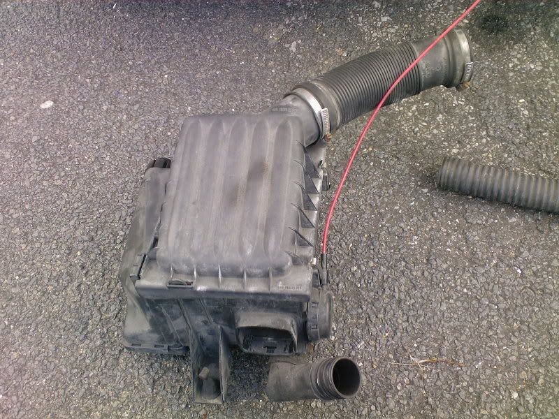

Airbox:
In place:
Where does this red tube thing attach?
Where does this pipe attach?
Also, I presume I need some kind of pipe from the bumper to get a cold air feed into the hole in the bottom right? Cheers
Mertin
Registered: 12th Oct 05
14th Nov 07 at 14:46   View User's Profile U2U Member Reply With Quote
That airbox you have is from an spi model so you wont need the red pipe
The pipe which is hovering above the manifold on the bottom pic attachs to the heat shield on the manifold. You wont have one so wont need it
