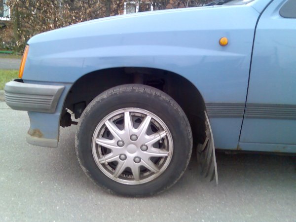

Fonz
Registered: 12th May 06
Location: Newbury, Berks
10th Nov 07 at 22:52   View Garage View User's Profile U2U Member Reply With Quote
Originally posted by dan_c4rsa
nope mk1's actually did come with side repeaters.
i second that!!
this is my C reg (1985) Nova!
Ste L
Registered: 3rd Jul 06
11th Nov 07 at 10:54   View User's Profile U2U Member Reply With Quote
My Mk2 nova didn't have side repeater's but passed MOT..
but as you can see the indecator's go further into the wing so you can see them from the side
