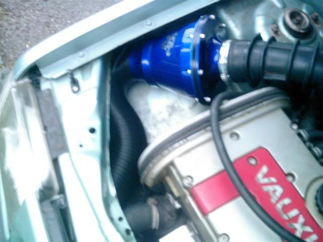

fitted xe in the corsa,all loomed up right but wont come down from 12-1300 rpm?
checked for air leak but cant see any,am i looking for a sensor to cause this?
tried to alter the little pin on the throttle rest to no avail.
give us a clue people!!!
Lee

try cleaning icv..
could also be the cts

where do i find this mystical icv i've heard so much about???
Ste L
Registered: 3rd Jul 06
16th Oct 07 at 17:58   View User's Profile U2U Member Reply With Quote
next to thermostat on front of engine...
just unscrew's with a spanner
next to coolant pipe in this pic
leekeefy
Registered: 8th Sep 07
Location: manchester
16th Oct 07 at 18:02   View User's Profile U2U Member Reply With Quote
so near the thermo housing?
Ste L
16th Oct 07 at 18:11   View User's Profile U2U Member Reply With Quote
yea, basically on it, screw's into it , iirc without looking
leekeefy
16th Oct 07 at 18:15   View User's Profile U2U Member Reply With Quote
theres 1 with a spade connector and 1 with a blue plug,i'm in the right place?
mac1976
Registered: 29th Dec 06
Location: tullibody , clackmannanshire
16th Oct 07 at 18:19   View User's Profile U2U Member Reply With Quote
thats not the icv its down behind the throttle body at the back of your engine, follow the hose that comes off to the right of your power cap and it the silver sensor
Ste L
16th Oct 07 at 18:21   View User's Profile U2U Member Reply With Quote
thats correct, i read it wrong, thought he said cts
just follow the pipe from powercap down, should have a 2 pin connector on that too
yes, the 2pin plug is the cts, just unscrew's

know the pipe you mean,so i'm goin under the car then
Ste L
16th Oct 07 at 19:43   View User's Profile U2U Member Reply With Quote
yes, easiest under car to get
