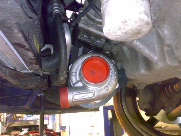

take one supercharger:

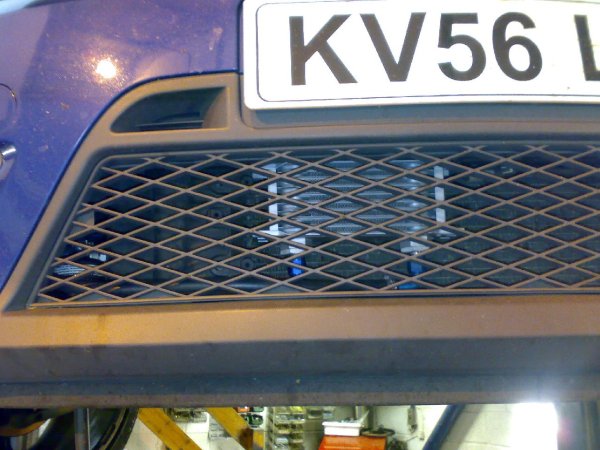

one supercharger oil cooler:
some pipe work
[pics to follow]
one fiesta st:
[insert mental image of fiesta st here]
put it on the rollers and do some mapping:
http://www.youtube.com/watch?v=wO_5OQO34Z4
http://www.youtube.com/watch?v=FjsjSk9uZI0
only mapped to 4k so far, need to put some milage on the components to make sure they are all solid..........
also changing the dump valve to a recirculating one, we only had a twin piston one lieing about so it had to do!

Thats cool! what kind of power is it looking to make once all remapped?

its a standard bottom end so looking to run 6psi with no intercooler, would most likely see 220bp on this car, then well add an intercooler and run 10psi.
looking at supercharging our own st which has forged rods and pistons in it, but well drop the comp ratio with some newpistons, then we should see 300bhp with the right mapping and cams

What superchargers are you using?

whats the standard BHP and figures of the st?
also isnt the supercharger in a weird place imo, wont it be prone to damge and stuff there?
What management are you using? and whats the cost of this conversion is it all custom or a kit?

broster
Registered: 6th Dec 02
Location: Drives: E39
13th Oct 07 at 12:23   View Garage View User's Profile U2U Member Reply With Quote
standard st's are 150bhp,
we were concerned with the location of the charger, but with trying lots of things, this is the only place it will fit and we have positioned it so that if you managed to hit the charger you will loose you sump aswell as the charger sits higher than the sump, also the mount for the charger will act as a guard. so we are confident that it will be ok there.
we use chargers from rotrex, but we spec them to suit our application.
management is standard, but we map it ourselves using the sct software
