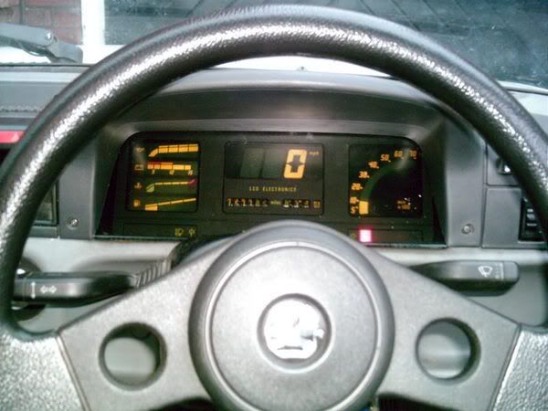

driving along. i look down, apparently im doing 122!!!!! Must of only been going 55ish.
What the hell is going on. I've check all the wires and the transducer etc etc its all fine, the gearbox plus isnt loose or damaged
Just done it after tunrning the car on this morning. Im resetting the ecu incase itss just programmed wrong but i highly doubt it as it works off the spindle. Urgh, so many problems.

ecu has nothing to do with a digi dash. maybe its a short in one of the wires making it read wrong pulses?

well im taking off the dash and everything soon just to see if anythings loose but i really cant think whats up at all.

yeh. I mean the revs, battery, oil and tmep are all fine. so why not the speed :@ :@

just taken out and cleaned the plug on top of the gearbox, was a little oily inside it for somereason, could that have been cacking it up?

flick the switch on the back of the digi dash

sure it aint in km? lol

good point indeed. turn the trip reset thing to the other side, see what happens

yeh ive flicked the little red switch back and forth for ages and tried it on both sides but it makes no difference what so ever.
any other ideas?

just looke dbehind the dash. there's a wire from pin 16 i think on the block going nowhere...........
black and green im pretty sure. should it be attached to something?
I dont think it was connected before though as its all taped up

no the trip reset thing on front of dash, turn it one way its kmh, other way its mph. u2u corsaCF for more info as hel helped me out with my digi dash problems a while back. knows his shit

look at your dash, does it say kpm, where is it says mph, next to the big "0" on the dash pic below...
if so, twist the trip reset, if that doesn't work, the contact's inside the dash maybe dirty, so will have to take it apart and clean them
