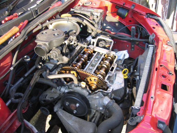

Well, it all started last week when I finally discovered and got a reliable answer that my cam chain needed replacing. A common problem on my X10XE engine, Z10XE and the 1.2 versions.
warren.g said he could do it for a bargain price, despite my 200 mile round trip to get it down (not a lot of miles Whittie, I know ) but still, for a repair you could get done anywhere it is a fair shunt.
Anyway, it was well worth it (albeit arriving far too early) and the car is running lovely now.

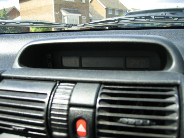

Leaving the services - temperature increase!

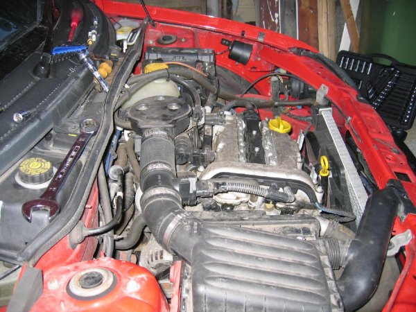

Rocker cover off. Spangly.

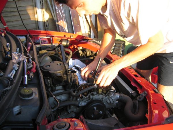

Reconnecting the timing chain.
All back together. Purring away.

Did he replace it? While you waited?
7th Aug 07 at 19:25   View User's Profile U2U Member Reply With Quote
Yup. Funky shizzle tools from Vauxhall. In short, you join the new chain to the old one, feed it through the engine, disconnect, then connect together the new chain. Vauxhall allow 1.5 hours apparently.
The mechanic I always go to says that it was an engine out job

That Vauxhall quote is a bit odd Planty. Warren said they allow 1.5 hours labour + parts + VAT will never equal £500. Unless the dealership doesn't know how to do cam chains

I think they were going to do tensioners and all sorts, which I'm lead to believe means stripping the engine down alot more than just changing the chain but seems un-needed since having just the chain changed has fixed the problem. One garage even wated to take the engine out to do it crazy
