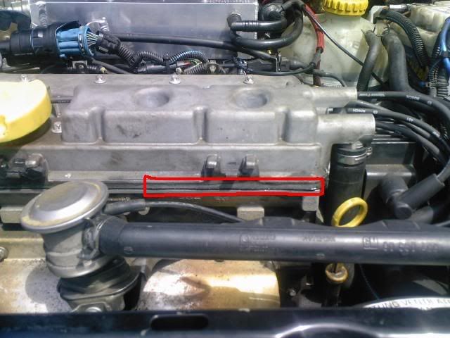

is it normal for a bit of oil to come out in the red box of the photo.
if i run my finger along it it has oil on it? is this normal
Vaux Lad
Registered: 15th Dec 04
Location: Stoke-on-Trent
16th Jul 07 at 14:57   View User's Profile U2U Member Reply With Quote
Nope.
The cam cover gasket is leaking.
eastend
Registered: 13th Mar 07
Location: Taunton, Somerset
16th Jul 07 at 14:58   View User's Profile U2U Member Reply With Quote
cheers,what should i do to fix it, does this affect performance??
[Edited on 16-07-2007 by eastend]
Vaux Lad
16th Jul 07 at 15:03   View User's Profile U2U Member Reply With Quote
Change the gasket. Or make sure the bolts are tight.
No
Altho you may get smoke from oil dripping onto the exhaust
AaronHorn
Registered: 30th Jun 06
16th Jul 07 at 20:52   View User's Profile U2U Member Reply With Quote
It's not really a leak unless it's dripping out... A bit of residual oil isn't really that much of a problem IMO
