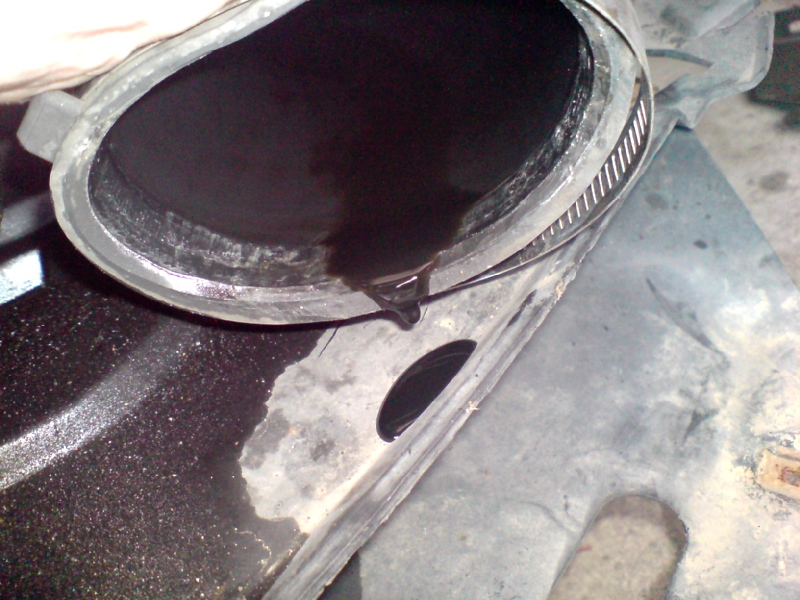

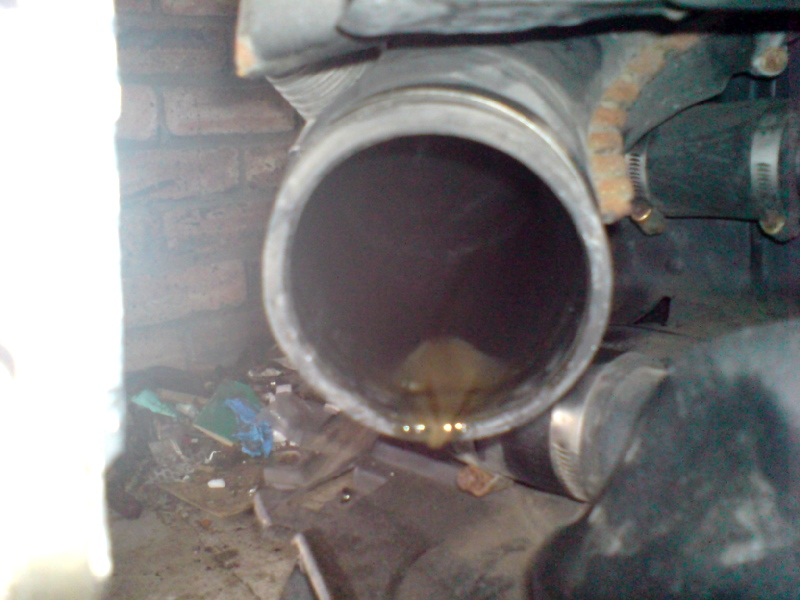

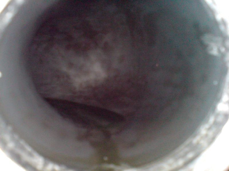

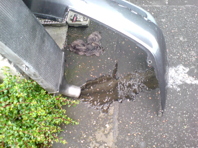

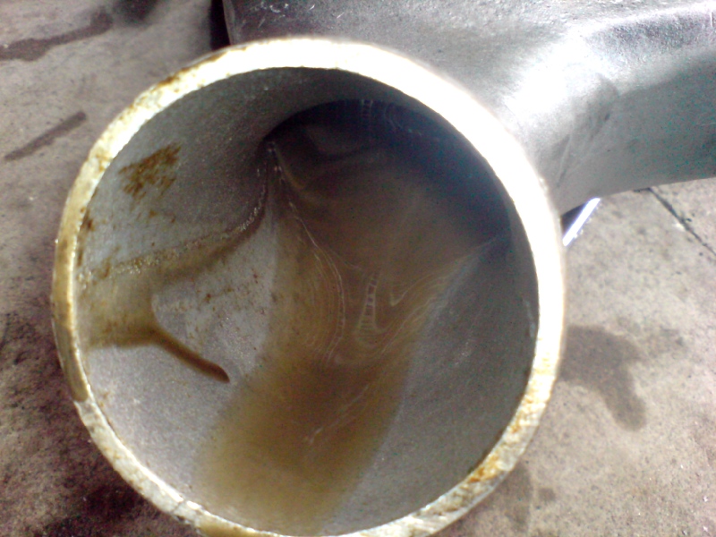

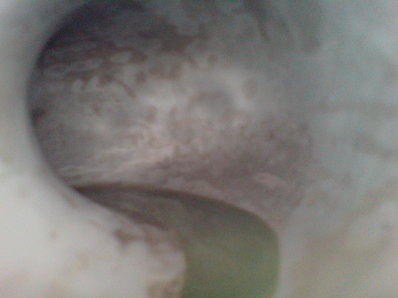

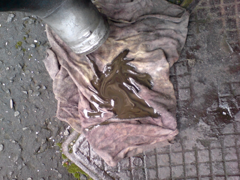

I stipped off the IC and piping to see what was lurking. :O
Poured a lot of oil out of the IC, and it was dripping out of both pipes into the IC.
inlet
front turbo intake side
no smoke.... couldnt see any smoke during test drive (up to temp), could not see any smoke at idle. Could not see any smoke (bar a wee black fuel puff) when pressing accelerator when stationary
One thing thats puzzling me is that if this is a result of oil being sooked up through the breathers etc.... why would they be quite 'dry'
If it was turbo seals would it not smoke all the time? Same with valve stem seals and rings.

a proper leakdown test will show if its stem seals/guides. probably turbo seals is my guess.
