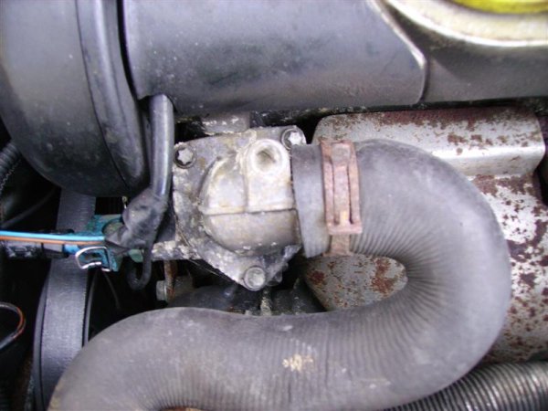

Couldnt see a bleed valve or anything on the thermostat Have i got the wrong end of the stick? The haynes manuel says it should be on the top of the thermostat where that hole is in mine.

They changed the thermostat design over the years. On my old 1.4 16v it had a bleed screw but o the new one it didnt.

Right i fitted new o rings and clips so hopefully that cured the leak. Refilled the sysstem and ran it until it was warm and bubbling with the cap off.
Only i think the system still has has air in as the large hose coming from the thermostat pictured above still feels like it has no water in and just air. because if you squeeze it it dosent feel like there is any pressure in it.

that pipe wont have any coolant in it mate. Not until the thermostat opens up anyway
24th Mar 07 at 13:21   View Garage View User's Profile U2U Member Reply With Quote
yer i let it warm right up so it was open
still not alot in it
