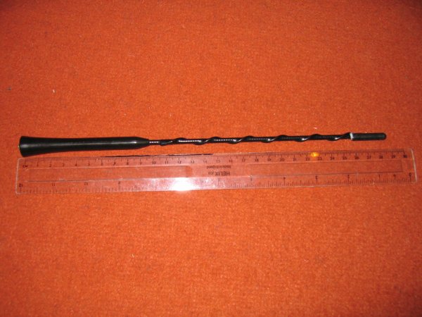

...story is, I've been trying to find a shorter but genuine Vauxhall aerial as I know they are out there. Normal aerial is about 42cm, shorter aerial is 27cm.
Found guy on eBay, said the aerial was off a Vectra but was 18.5cm, twice, in 2 emails. Thought that a bit small but bid, won, £6.10 including delivery, bargain.
It arrived yesterday, and, ermmm, was more like 18.5inches so normal 42cm. Contact him through eBay, threatened negative feedback - he refunded me £6.10 AND let me keep the aerial.
Was bored, went out into the garage and did this quite proud of it really.
Made a hole in the cap at the top, chopped and stripped the main aerial. Bit of liquid glue, shoved it in, then bit of sealant (left over from Depos) to seal it.
Saved me buying another one anyway. And I won't be bothered if it gets nicked.

does it work?

Will it still pick up the signals just aswell being as it's shorter now?
28th Feb 07 at 17:45   View User's Profile U2U Member Reply With Quote
Can't see why not. The metal that twirls round it doesn't go straight to the top anyway.
Jules - will probably be just like a bee sting. But being so cheap etc, I'm not hugely bothered if it doesn't work.

looks erm normal good work though. should have asked got two of the tiddlers in the garage sumwhere
28th Feb 07 at 17:46   View Garage View User's Profile U2U Member Reply With Quote
There's a metal bit in the centre too.

lol that's the idea, but shorter, which it is.
So you have 2, 27cm Vauxhall aerials in the garage? doh :
Robin - there isn't. It's like a white, fibre glass thing. Similar to the fibreglass bit you get in the Halfords paint touch up pen kit things.

The lengths of the aerial are a certain length to get the correct sware (swr) to get a good reception, increasing or decreasing this will have an effect.

You should make it either half or a quarter of the current length for it to work best.

Do you mean half of the 42cm or the one I've made? Why would it being that short make it work best?

Length of aeriel is related to wavelength of the radio signals.
If you just randomly cut it it won't be as efficient as one thats been cut to a proper length.
28th Feb 07 at 19:12   View User's Profile U2U Member Reply With Quote
Ok - it's worth a try anyway. If not I'll be getting a shorter one from Vaux.
