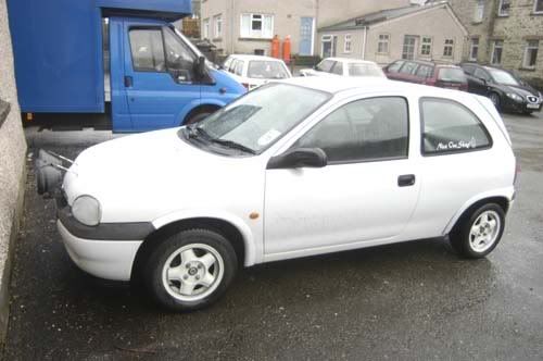

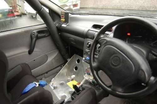

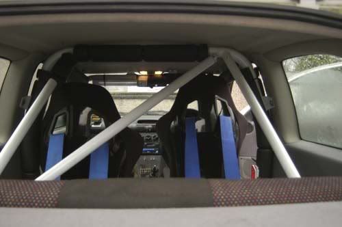

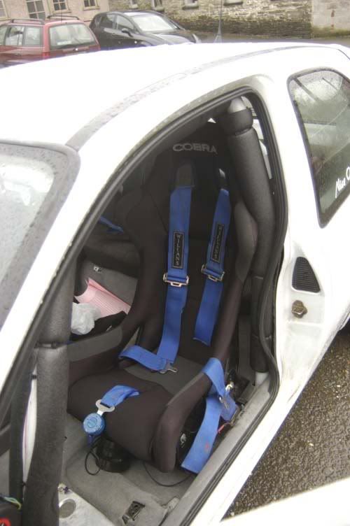

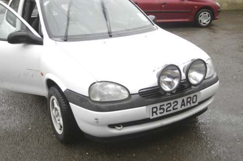

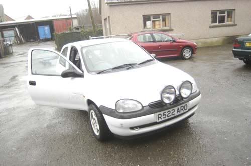

Just a random urge to post pics of my corsa to get some feedback from others.
wasnt built to look particularly pretty as its a rally car but all the same ive tried to keep its appearance as presentable as i can.
Edit to include spec :
X14XE engine with induction kit
Ashley cat back 2" bore exhaust system
F13 gearbox with close ratio cluster and altered final drive from 3.7:1 to 4.1:1 no lsd yet
Bilstein rear shocks with -30mm springs
KYB ultra SR front shocks on standard springs, for now, Bilstein to come soon.
13 inch GRP A revolution RFX rims
Mintex heavy duty front discs with mintex M1144 pads biting them.
OMP 10 point rollcage
Cobra suzuka bucket seats
Willans 6 point harnesses
Brantz Rally timer
Cibie turini spot lamps
Works spec sump guard (11mm thick)
custom made tank guard
all pipework underneath skidded with alloy for now until i get time to pull all of them off and run new ones inside the car.
Future plans include :
ZF limited slip diff
4.5:1 crownwheel and pinion
Bilsteins coilovers for the front
Disc braked back beam
Vertical hydraulic handbrake
Quickshift linkage and a few other little bits
Yes it has been rallied, only once though as it was finished friday night and competed saturday night, next even will be 14th and 15th of april hopefully.
new pics to be added tomorrow hopefully
[Edited on 08-02-2007 by Dafz]

7th Feb 07 at 19:12   View User's Profile U2U Member Reply With Quote
need a clean!
RFX's
7th Feb 07 at 19:13   View Garage View User's Profile U2U Member Reply With Quote
Adam Petherwick part 2?
7th Feb 07 at 19:13   View User's Profile U2U Member Reply With Quote
lol what size are those wheels? look tiny!

Originally posted by M2RTY
need a clean!
it's fine

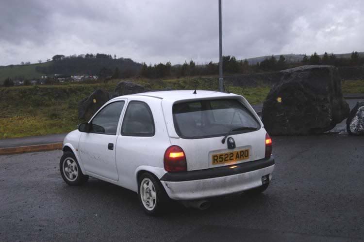

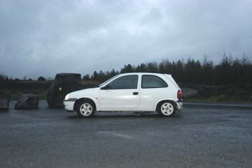

also why have you lowered the rear but not the front?
7th Feb 07 at 19:15   View Garage View User's Profile U2U Member Reply With Quote
7th Feb 07 at 19:17   View Garage View User's Profile U2U Member Reply With Quote
lowering the rear but not the front has nothing to do with rallying and will make it handle crap
7th Feb 07 at 19:18   View Garage View User's Profile U2U Member Reply With Quote
does it ever do any rallying?
7th Feb 07 at 19:19   View User's Profile U2U Member Reply With Quote
Spec?
7th Feb 07 at 19:21   View User's Profile U2U Member Reply With Quote
i do have to admit, not many rally cars still have there interiour, let alone the rear seatbelts
but with the front lower it will look very IMO
Butler
Registered: 2nd Jun 05
7th Feb 07 at 21:39   View User's Profile U2U Member Reply With Quote
endurance and road rally cars do
Dafz
Registered: 5th Feb 07
8th Feb 07 at 02:28   View User's Profile U2U Member Reply With Quote
RFX's
13 inch GRP A revolutions
this conversation popped up before, i had it lowered 60mm all round but it handled like shite so i lifted the front as that was my main problem, had no feel on the road. its since been lifted at the rear.
indeed the rear seats and door cards etc are only there because they have to be, road rally regulations.

wat rallys do u take part in?

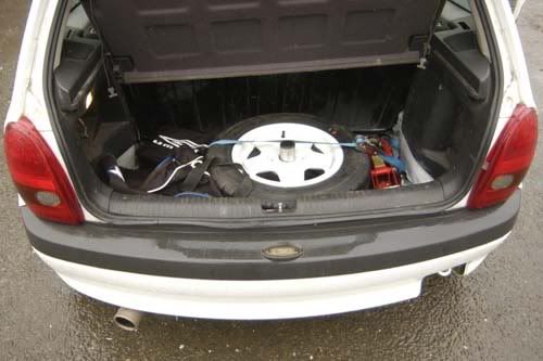

few new pics
jus a few
excuse the shite inside the car, i cant be arsed to clean it.

get that rear wiper off, think of the weight

Lose the airbag! Knowing some of the roads they use round here id be scared of that thing going off!
Dafz
8th Feb 07 at 18:37   View User's Profile U2U Member Reply With Quote
good point mate, gonna happen soon, as soon as i know how to keep the warning light off and wether itll feck something up on wiring side of things, i.e will the car start and run fine with the air bags off if it thinks they have been deployed.
