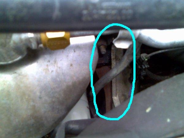

Hi,
I have an oil leak for so long now and its annoying that I have to top it up so frequently.
Well, a while ago, I cleaned the whole engine to make sure no oil was there and then ran it, and checked it. I remember seeing oil coming from the bottom of engine/gearbox, where they attach together:
Anyway, I have just checked now, took the above picture, and its covered in it, its even higher up but am still sure its coming from where I said (Also be seen in the picture)
Is there a gasket in between here and will this leak be difficult to fix, thats if its where it is coming from.
Thanks
Edit: As you can see, the image was taking from looking underther car from the front, you can see the front of the exhaust and the part in question.
[Edited on 25-01-2007 by freestylerx]

rearmain seal - the seal where the crank turns
gearbox out and flywheel removed job

did you follow it up? did you find out where it might be comig from?
I had similar some time back, turned out to be the rocker cover gasket

Thanks,
is this the proper name, rearmain seal?

No its not coming from in the picture

i have the same problem mate, already changed rear main and rocker cover gasket, still leaks, hoping its the sump gasket, or I cant think what else it would be!
