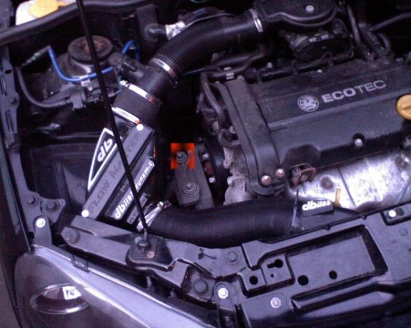

This morning had the diblas flowmaster fitted
now i can hear a ticking sound coming from somewhere in the engine bay
its not tappets or anything like that as this morning when i drove down to have it fitted with standard air box not a single noise
now i've got this ticking noise not a happy chappy £178 for the flowmaster
thing is the flowmaster has improved the car no end just could do with out this noise
they have fitted it to the engine mount, nothing is loose or causing it to knock against anything
any ideas

on the diblas website it shows one fitted and also a member on ccuk has one fitted like this:
mine is different its on the engine mount thats how its secured down not moving around or knocking anything
would it make any difference that its been fitted to engine mount would that cause the noise you think?
someone has mentioned the 'mass air flow meter'
would that make a ticking noise if needed replacing?

possible fuel tank vent valve-sits right by where OEM airbox was
17th Jan 07 at 09:15   View User's Profile U2U Member Reply With Quote
Charcol canister id suspect
Doug
Registered: 8th Oct 03
17th Jan 07 at 11:45   View User's Profile U2U Member Reply With Quote
I would suspect something is knocking,
what about that black pipe up my the top mount? is that secure? I wouldnt strap anything down to the engine mount as it moves about with acceleration.
johnhara1
Registered: 19th Oct 06
Location: Newcastle upon Tyne
17th Jan 07 at 12:55   View User's Profile U2U Member Reply With Quote
is it not knocking when the mount flexs? with engine movement?
ShEp
Registered: 9th Aug 05
Location: Dingwall, Highland
17th Jan 07 at 13:45   View User's Profile U2U Member Reply With Quote
the bolts on the pulley chapping off it?
dunno unless i was looking under the bonnet
