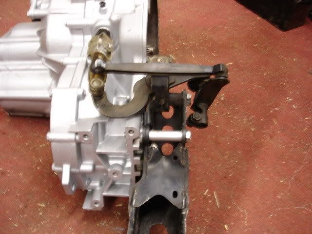

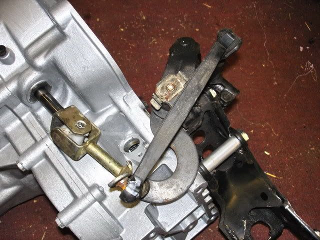

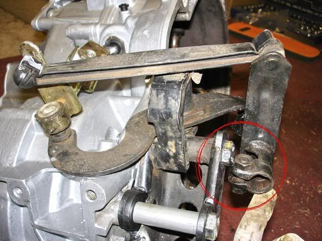

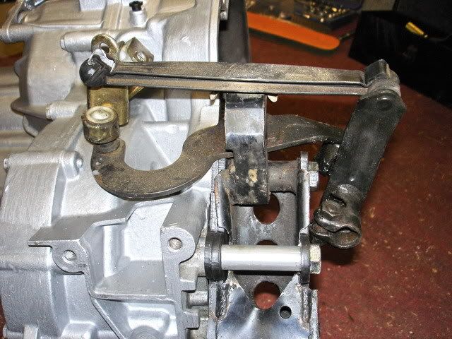

Hello,
I had a go today at mounting the shifter linkage to my F28 Box. It went on ok but I have a problem with selecting 2 of the gears....
The area highlighted catches when I try to select these 2 gears...
Could you please tell me if I have used the correct linkage and fitted the mount spacer plates correctly? heres some more pics so you can see it
And if I have done it correctly, what have over people done to avoid this problem???
Thanks for any help / guidence.
Neil

Nic Barnes
20th Dec 06 at 05:44   View User's Profile U2U Member Reply With Quote
neil, what you need to do is shorten the part of the linkage that actually connects to the box. i shortened mine so there was 10mil roughly between the bracket that sticks up for the plastic bar bit and the end that connects to the box. i hope that makes sense, if not, ive got pics of it on my computer somehwere i think

Argh I see... that would have the effect of bringing the female connecter end backwards clearing the bolts that its presently fouling on. Is this problem just because of the F28??? As the setup you see in the pics is exactly what we were using on the F20 The gold coloured bar your on about shortening is actually a Nova item as we found the length was perfect.
Cheers
Neil

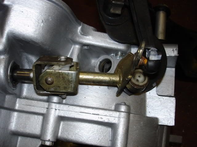

Novaneil
Registered: 26th Oct 06
Location: Leamington Spa
21st Dec 06 at 13:09   View User's Profile U2U Member Reply With Quote
I take it this is the part I need to shorten?
Neil
SportBoy
Registered: 5th Oct 01
21st Dec 06 at 18:33   View User's Profile U2U Member Reply With Quote
yeah that bit needs shortening .. take as much off it as you put on it for an f20 .. would work out to be about 10mm that rod then as muppet has said
Nic Barnes
21st Dec 06 at 19:05   View User's Profile U2U Member Reply With Quote
mine is shortened more than 10mil
