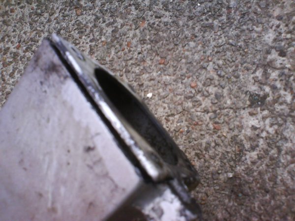

This end of my inlet has completely snapped off now , leaving me with an open box for an inlet
I have a welder but the metal that goes back on is all snapped so it cant be welded back on.
Its bodged just now and obviously I am not leaving it that way !
I dont have access to any sort of tools that could cut the circle for the air to pass through , to make a new end piece but what sort of tool do i need to do such a thing ?
Any other ideas ?

Some ally/steel and then a hole cutter for metal that is the correct size.
Go and see your local fabricating shop. They'll fix it in a jiffy.

Want to do it myself though , seen as how Ive got the welder.
Are metal cutters available at B+Q etc ?

looks to be plenty of metal left to weld to to me. can u not just clean up the edges and reweld it?

looks like an alloy to me.........or cast.
unless you have alloy wire for a mig or a tig welder. let a pro do it

Not just a case of buying ally wire then
18th Dec 06 at 20:08   View Garage View User's Profile U2U Member Reply With Quote
Gregor, if the bloke who made it welded it badly, will your welding be better?
Get it welded by an engineering firm.

The reason it came apart was because the welds were ground back to much.
Its worth a try before spend spend spending

if its not steel, dont bother welding it yourself. unless you have a dc tig welder

if you are after a hole saw you want a hss hole saw (high speed steel)

Got it all sorted
Doesnt look great but its air tight
