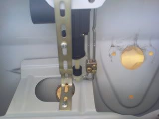

ok there's a pic of mine was a bitch but works bang on as for wiring it easy,
the green goes to ground, the blue run through the car or whereevr you put it,
wiring the relay
termnail 86 - perm 12v
terminal 85 - from switch
terminal 87 perm 12v
terminal 30 to blue wire
