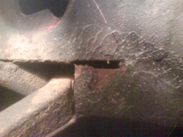

As you can see I have a hole about 10mm by 20mm.
This was all "welded up" in the summer but I thought id see if it would withstand the test of a slight knock with a screwdriver , and alas the screwdriver went straight through it
Now , I'm going to weld this back up my self, properly !
Whats the best way of doing this ?
Do I cut back around the hole untill "sound" metal is exposed , then plate over it ? ?
How thick should the plating be ?
Cheers
Gregor

plating about 1.5mm, grind back till you find something good to tack onto, then weld it up! remember to tack it in several places before you weld the whole lot up to avoid any warping of the plate.. and to avoid too much heat bulding up.
24th Nov 06 at 21:44   View Garage View User's Profile U2U Member Reply With Quote
yes, cutting it back, and welding 2mm plate in woulc do.
BUT, with it being where it is, I'd DEFINITELY not be doing it myself.
[Edited on 24-11-2006 by Robin]
definately (just realised where the hole is!

Why ?
shane2corsa
Registered: 4th Sep 05
Location: Nettleham, Lincolnshire
24th Nov 06 at 21:54   View User's Profile U2U Member Reply With Quote
its right near a vital suspension mounting, if too much amps is used when welding it could actually be made worse, or even weaker! just be careful or if in doubt get a decent garage to weld it.

Fuck that.
Ive been messed about by the people who are supposed to be proffessionals.
If I cock up then I cock up , only one way of learning eh ?

yeah just have a practice on some thin plate before you start then you'll know how many amps to use. good luck

Also make sure you put the correct products on after to seal it in.

What do you recommend ?
These "welders" have just slapped on waxoyl

not good. first blast any rust off with a wire brish in a drill, a good zinc based primer 'davids zinc 182' is very good, a couple of coats of that and left to dry or an etch primer. then a few coats of the hammerite underseal with added waxoyl will sort it.

To seal it in, slap a bit of etch primer on it, then some paint, then some under seal. You can put a bit of waxoyl ontop of that too

underseal first n then paint. wots the point in painting it to underseal over and ull never see the paint ed...

Ive got some 1mm steel here , should I double that up ?

All welded back up on wednesday night.
Withstood the hammer test , Im well chuffed
