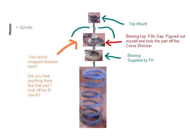

The piece before the 2 suspension bolts I added off my original Corsa Shockers. Is that what they mean?

i think so phil? the bearing of the top of the original suspension?
VegasPhil
Registered: 16th Jan 05
13th Nov 06 at 12:39   View Garage View User's Profile U2U Member Reply With Quote
Yep. I used that.
Did you fit it to yours? Looking at the shape of it, it takes the pressure off the Spindle.

Did you get a part like that on your original C shocks?
I could see that there was a part missing when I put the coilovers together. Took me a while find and put the part off my original shocker on. So I can see why they broke now, would be putting a load of stress on it.

Wasn't the top mount though Adam? From what I can see it's the part that fills the gap between the FK shocker bearing and the Top mount?
yeah there is a top mount bearing on my original suspension, altho it is a lot bigger and couldn't see how it would fit onto the FK's.
yeap - about 20mm thick and 40/50mm long - this snapped so the front unit was no longer connected 2 the car at the top.
I just sat it on top and pushed it through. It looked a bit big, but sat flush to the top mount side in the wheelarch. Are you running standard shocks again on the Corsa now? Have you taken the coilovers off?

I've whipped up a diagram, so you can see what i'm chatting about. See if we're going on about the same thing
2 secs!
Corsa 2.0 16v Vegas - Sold
VegasPhil
13th Nov 06 at 13:41   View Garage View User's Profile U2U Member Reply With Quote
There mate. That should explain sort of what i'm on about.
