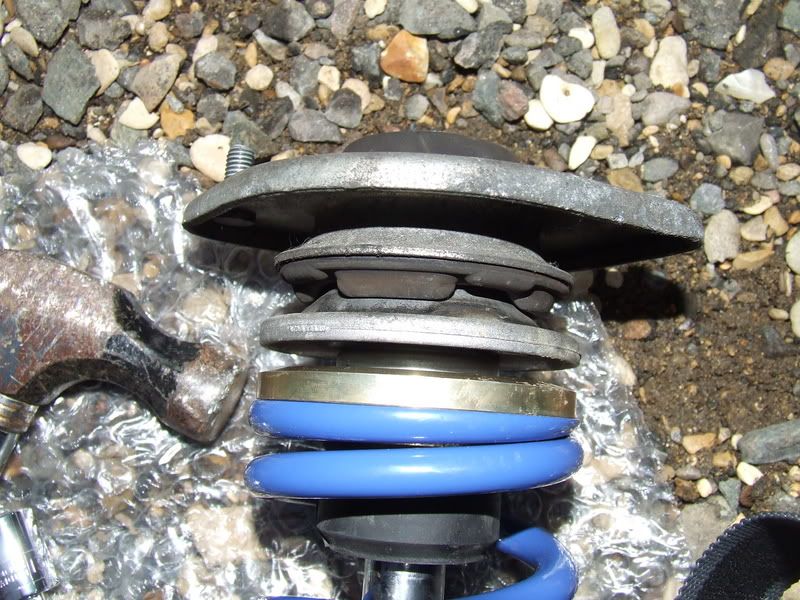

I started fitting my coilovers today, but im having trouble fitting the top mount correctly, and im unsure which is correct.
This is how i have done it at the moment
Can anyone tell me if this looks ok?

nope, you need to put the black plate on first that has the bearings in it then put the rest on. otherwise you will damage the top of the bit connected to the blue spring.

Black plate
There is a black thing in between the gold plate and the top part. Is that what you mean?
Thanks

think you have left out the bearing plate.

can you update the pic with the right order?

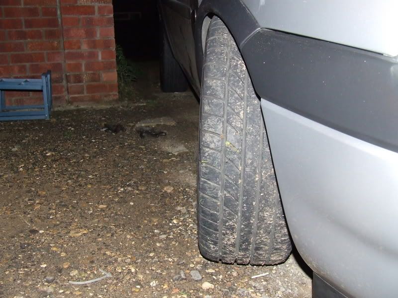

Right, i sorted it out, and i have now fitted them. Trying to set them up is rediclous. At the moment my wheels arent even inline with each other. Is there any particual way i should go about setting them up, or should i get someone who knows what there doing.
Thats both front wheels, with the steering steering wheel straight.
Anyone know what wrong, its annoying.

I have been told its out of toe?

you have obviously done something wrong.

this is how mine were to wen i fitted them,you just have to adjust them with patience and it should be ok and get the camber and tracking done to it makes such a diffrence
