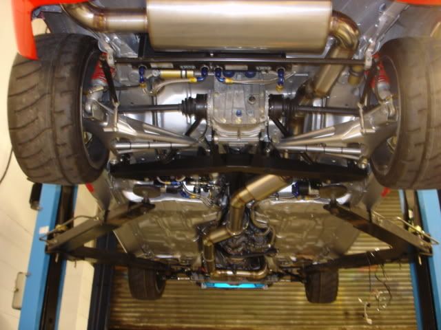

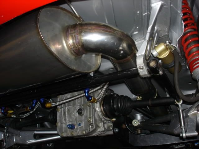

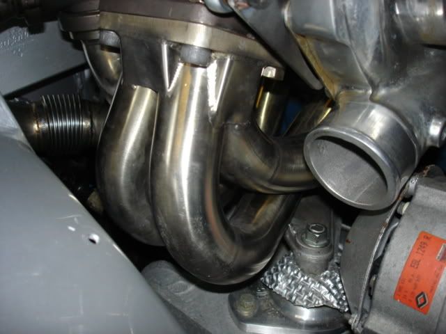

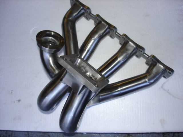

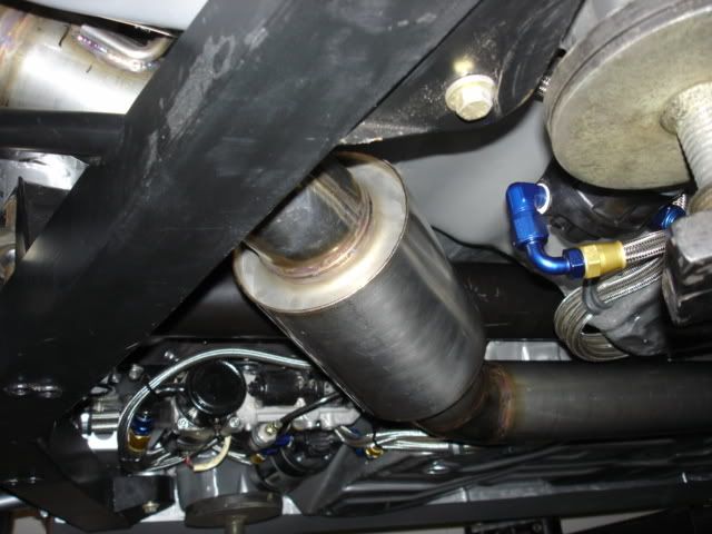

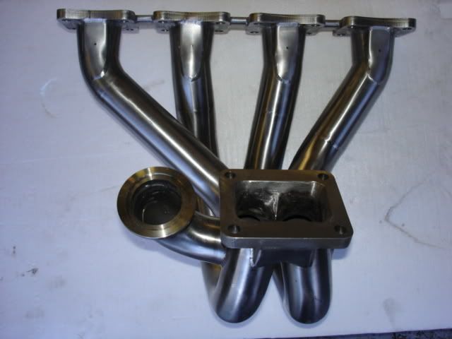

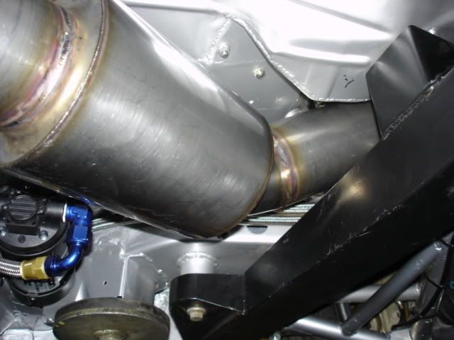

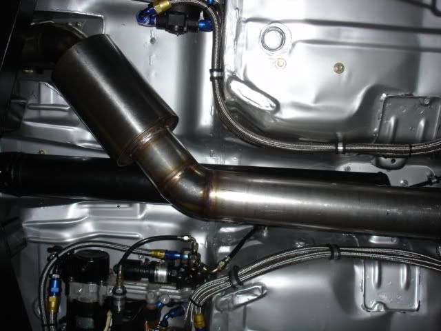

[quote="martin-reyland"]Primary designs have now finished the exhaust and insisted on making an inconel manifold while they had the car. The quality looks superb but my main objective was to have a quiet system... so how does it fair? Well we had it running today and the result was.... the fuel pumps are noisier than the exhaust :cry: The car makes about the same noise as a standard car with a factory exhaust... D:
Have driven the car in mid air (on the lift!) and all gears are present... sequential is weird man :eek:

Quality of the exhaust looks excellent
Just shows that you get what you pay for

should have got a mandrel bent system rather than a section welded one. probably too big for most mandrel benders though.

Mandrel bent would squash the pipes though, hence by using this type, you keep a true 3" throughout.

no, compression bends would crush the pipe, mandrel bends dont.

erm...the 90* bends were probly mandrel......
whats the difference
21st Oct 06 at 13:20   View User's Profile U2U Member Reply With Quote
mandrel wouldnt compressing the pipe, its keeps the same diametre the whole way through

why does the exhaust snake so much ??
90 degree bends cant be good on the flow of emissions can it ?
