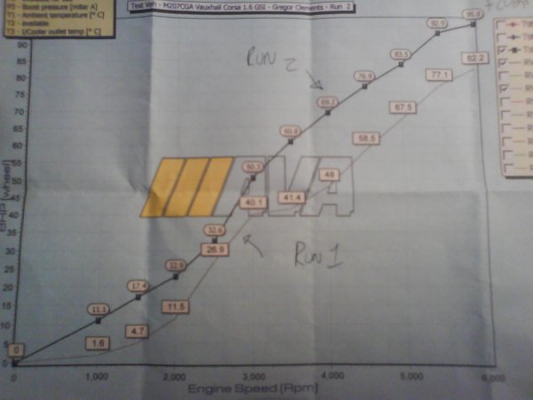

Gregor
Registered: 28th Nov 03
14th Oct 06 at 19:44   View User's Profile U2U Member Reply With Quote
Corsa with x16xe
1.6 16v c16xe
Inlet Manifold
4 - Branch Manifold
K+N
Full stainless with de-cat
115.8 bhp
That seem ok for what work has been done ?

pic of the graph?

what rolling road was it?
Gregor
14th Oct 06 at 19:52   View User's Profile U2U Member Reply With Quote
Yeh I expected a bit more , but I am still using a 1.4 ecu so its running rich.
Got some issues to sort out with it and then it will go back
Gregor
14th Oct 06 at 19:53   View User's Profile U2U Member Reply With Quote
It was AVA Turbo but I dont see that being much use ?

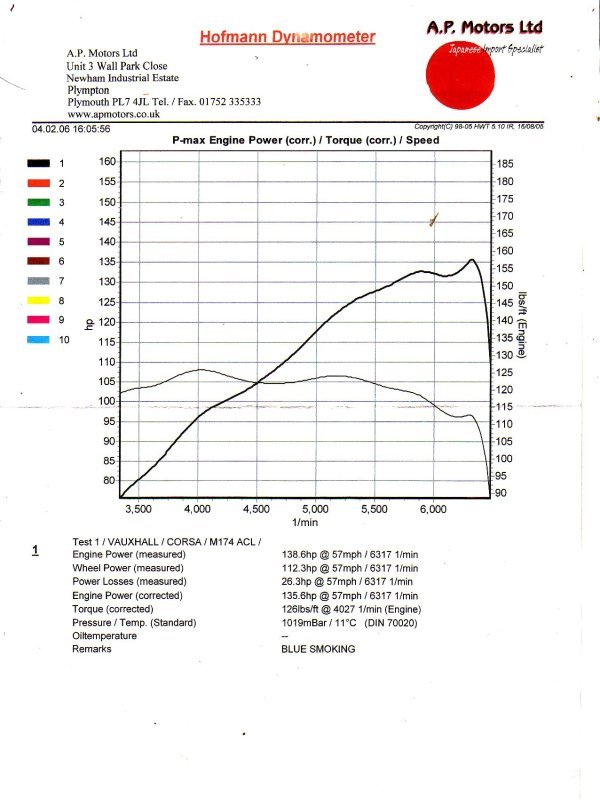

my c16xe with inlet manifold, 256 piper cams, air filter and exhaust made 139bhp... something cant be right, seen many c/x16xe's with just an inlet and exhaust showing around the 130bhp mark un-mapped...
post up the graph if you have it, remember seeing it on mig somewhere.
yes your rolling road was dodgy

ckallis500, is this your graph (found on mig)

greg, post your graph on here. did they give you a torque reading as well. and they only reved it to 6krpm as well
Gregor
14th Oct 06 at 20:31   View User's Profile U2U Member Reply With Quote
It was cuttiing out after that dave.

how did they manage to do a graph from 0rpm? what gear did they test it in and what was the torque reading?
14th Oct 06 at 20:37   View Garage View User's Profile U2U Member Reply With Quote
there's more power in that engine, the curve is still climbing.
