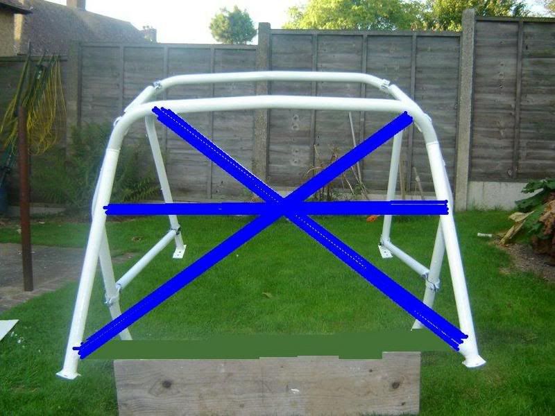

Anyone done this??
The cage i have brought doesnt have any diagonals and i want some as well as a bar for harnesses.
I can weld so thats not a prob but you need to shape the bars to fit the cage.
worth tackeling my self or taking to someone?
Rob

well at the mo it doesnt have the bits ive drawn on in blue and i want them!

10th Oct 06 at 15:33   View User's Profile U2U Member Reply With Quote
Or like this

called fishmouthing. just do it urself with a grinder

if you can weld and get the proper size and strength pipe may aswell give it a go

only thing im worried about it the "fishmouthing"
10th Oct 06 at 15:36   View Garage View User's Profile U2U Member Reply With Quote
you'll be fine with a hole cutting drill bit of the right diameter

thats not the right was to do it tho is it?
Thought the right was was to "fishmouth" a bar onto a solid part not drill hole and slide in and weld????

you can use the hole cutting bit to fishmouth though

can you??? explain!
10th Oct 06 at 15:41   View Garage View User's Profile U2U Member Reply With Quote
no, you have to cut the profile of the bar you want to join it to from the end of the bar you want to join to it, if you use a hole cutter which is the right diameter, you can make the fishmouth

or just take it to any welder, fabircator and they could prob do it a piece of piss for about 50 odd quid

you need a Hole saw and pillar drill, Grinder with sanding disk on to reshape as some of the ones you need a hole saw will not do.
then if i was you make the pipes and get somone to TIG weld them as look tidyer than MIG

You don't use a hole cutter to fish mouth do you? I thought you used a belt sander with appropriate sized dies on the end to give you the right diameter. Thats how I have always done it, nice an accurate too.

there is fishmouthing tools BUT cheapest way is like said hole saws.
what i used on 90% on my white one.....
10th Oct 06 at 19:41   View User's Profile U2U Member Reply With Quote
Oh right, can't be a bad way to do it then really
