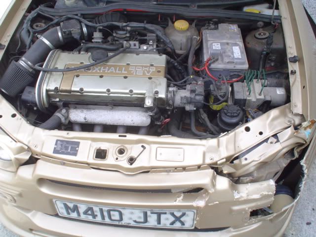

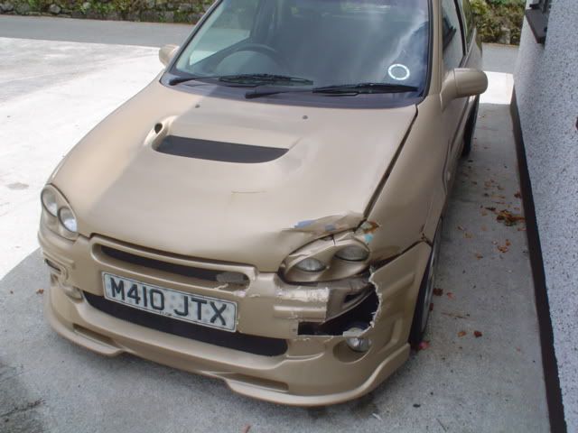

Unfortunately I have just written off my C20xe corsa, but I have now purchased a Let corsa. My old corsa (94 GSI) had a Toad Cat 1 alarm fitted, and my new one did not (96 1.4 sport). I noted down all colours and have been quite sucessful in putting the alarm in. Everthing thing works accept unlocking the central locking from the remote. Any ideas?
My old corsa
