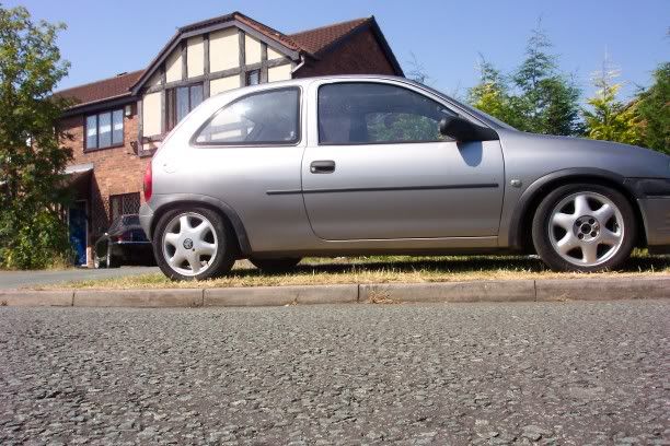

its just right
Planty02
Registered: 5th Mar 05
19th Jul 06 at 14:07   View User's Profile U2U Member Reply With Quote

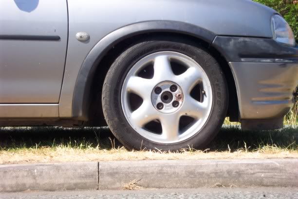

I wouldnt go any lower mate - you might start having problems with catching sump etc
boyracer2002
Registered: 10th Aug 02
i thought it would be tucking more tyre than that tbh when i saw the sump (you must have big hands) looks well
a_j_mair
Registered: 23rd Jan 04
19th Jul 06 at 14:08   View User's Profile U2U Member Reply With Quote
i wouldnt personally
my front cross member thing behind the bumper sat about 100mm tops off the road, was really a bit low TBH fucked the handling and took a couple chunks out the sump
namkeaps
Registered: 25th Jan 06
Location: manchester
19th Jul 06 at 14:10   View User's Profile U2U Member Reply With Quote
be interesting when it comes to driving it lol
its only on -40mm nova gmax springs and shocks and an xe under the bonnet

If the theory includes only your centre of gravity then yeah, it'll be excellent.
If you factor in limited suspension travel, stiff springing, visits to the bump stops occasionally, geometry thats wrong because the its out of tolerance and a lack of real ability to adjust the relative lateral stiffness of each end of the car, then things start to look worse.
Its got enough grip and the weight is forward so you've a fairly light stiff back end, which helps reduce what should be a very understeer tendency. Net effect of that though is they get snappy if you take too much advantage of it.
You're probably right in how it feels, but thats not entirely down to the choice of ride height.

20th Jul 06 at 12:33   View User's Profile U2U Member Reply With Quote
very true ...
The problem i can see me having is the weight distribution because my rear is stripped out.
I now have a rear stut brace to stiffen up the back end and for somewhere to put the harnesses to.
When doing the wiring for the loom i may see about re-loacating the battery to the rear. Not really much else i can move to try and spread the weight that is already in the car other than adding more weight to the back?
