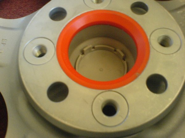

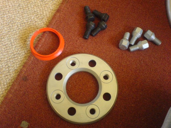

Right they have a sort of spacer thing for the back that you have to use to fit them and im trying to work out how it goes on, think ive worked it out but obviously want to make sure its correct.
These are the parts that come with it, spigot ring, bolts and spacer thingy.
Spacer thingy has 4 normal bolt holes and 4 threaded holes.

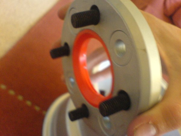

I think it goes like this,... its obvious where the spigot ring goes,then the four black bolts bolt the spacer onto the hub leaveing four threaded holes.
Then the silver bolts go through the wheel and into the four threaded holes that are left.
That sound about right ?

i would have thought it'd be the other way round
Rob B
Registered: 8th Jan 04
13th Jul 06 at 10:55   View User's Profile U2U Member Reply With Quote
Explain ? on the other side its clearly ment to have the black bolts through as there is like a recess coned sort of shape for the bolt to sit in.
And the spacer deffinetly goes that way as its the only way the spigot ring fits in
Jake
Registered: 24th Jan 05
13th Jul 06 at 10:56   View User's Profile U2U Member Reply With Quote
you're right.
