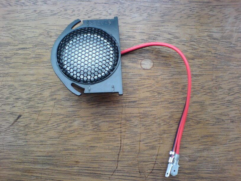

Is it possible to fit aftermarket tweeters in the standare tweeter spot on a sport? i know this has been asked b4 (i did a search) but no1 actually answered it? lol these the the speakers i might get? http://caraudiosecurity.com/shop/product/products_id/508.html
Will these fit, i read the Faq and it says there the right size, just i need an adaptor AND do i not need a crossover ????????????????????

yep shoul fit u need 2 remove the handle surround and open the hole out til the tweeter fits then glue it from the bacck and pop it on.
thats how i did mine plus i put tweeters in the holes 4 the mirror adjusters,it should b a piece of pi55

I used the bracket that the original tweeters sit in and flattened it down and drilled it out. Then I glued on my JBL tweeters
The component set should come with 2 crossovers.

i have done ill go take a picture for you.
