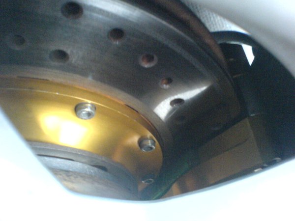

Finally got round to fitting the 4 pots but as usual I made things more difficult than they needed to be. I decided to completely remove the ABS system so that meant new servo, master cylinder, all breaklines needed to be replaced, clips...... well, it was a bastard of a job!
but they are on at last
the stopping power is immense but the car squirms all over the place and locks up. I might try some Whiteline front and rear ARB'S to see if that helps stabilise it all.

yes, 12mm of them and longer wheelnuts and longer locking nuts.... was a bit of a pain in the arse to do really so many extra bits needed.

well, would have got away with 10 but the wheel was sooo close to the caliper.

ARB's wont help much It'll be the back wiggling
You'll need to dick around with bias settings

brake bias.... that sounds expensive and fiddly
as for the squirming, I noticed it did this a lot more after removing the front ARB so it might help fitting a new one.

Get a bias valve.... about 50-80quid...
re-plum your rear lines through the car (one line, then split to two brake at rear)
fit the valve in the cabin

they are the 300mm kit. my compomotives will go over them fine its just the speedlines that cause problems. the spoke curves in quite sharply and deeply and catches the front of the caliper.

a valve
in the car (two fitted.... long story... intention wasa to have one line t'd from MS, the T'd off again at the rear beam to the rear calipers

but on the corsa I have plumbed a splitter block in with the two lines from the master cylinder being split into:
front left and rear left
front right and rear right
thats how the standard corsa without ABS is set up. So you are saying to take 1 pipe off the MS to the front and 1 to the rear?

leave the fronts....
1 pipe with valve to the rears

so 1 pipe from the MS split into 2 for the fronts and the other from the MS split into 2 for the rear?
