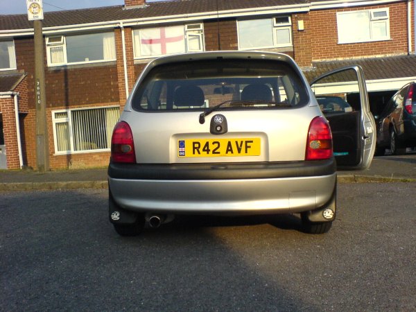

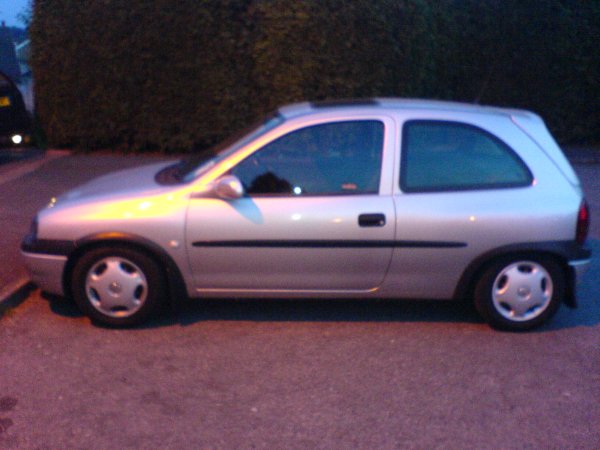

**Update**
Done the rear and the nearside front, but it got too dark to do the drivers side...
Thought it was pretty easy considering i've never fitted suspension before...
Quick question though, the top nut on the front only seems to have about 2 threads showing at the top of the nut....is that ok ??? seems like the OE stuff only has around the same amount of theads showing, but just wondering if the GMax stuff was likely to differ ??

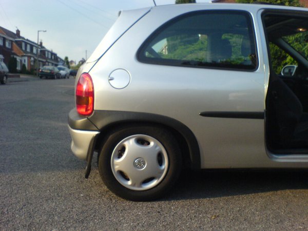

17th Jun 06 at 22:21   View Garage View User's Profile U2U Member Reply With Quote
Just rear done...
...and the front nearside and rear done
