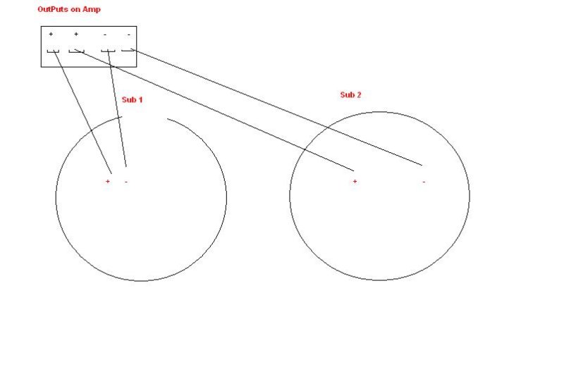

below is diagram of how I have wired them in

one option you have is to wire the subs like this
and use an amp giving about 600W RMS at 2 ohm
or get a 2 channel amp which gives 2x300W RMS and wire the subs to show 4 ohm

i tried wiring subs like that on my amp and still didnt work - will look for new amp now, cheers for your help mate really appreciate it

There are two positive terminals and two negative terminals but only one channel, the reason there are four terminals is to make it easy to connect two subs,
