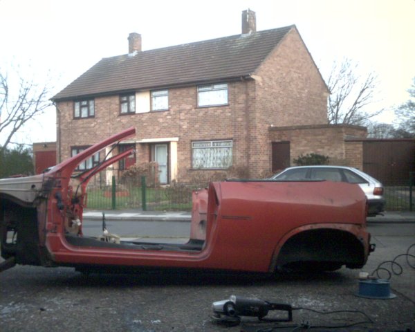

the b pillar is 3 skins thick
i know i cut a roof off a corsa to see
i would just weld it up
