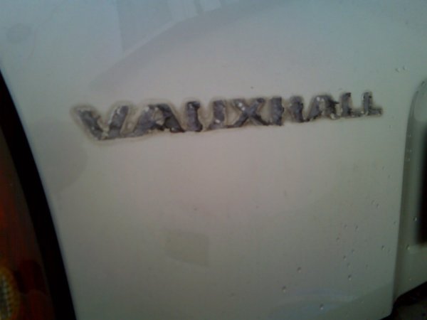

thinkin about takin the rear badges of my car, just wonderin will it leave any marks? cheers

if done correctly, no

get an expired credit card, heat with a hair dryer (i didnt use this), i used a cloth with very hot water and left it on the badge for 1-2 minutes,
then use the credit card to remove the badge
and get a bug/tar remover to remove the glue (i used Gunk engine degreaser) or white spirit. If needed, re-use hot water for some more time on the glue
clean and nice

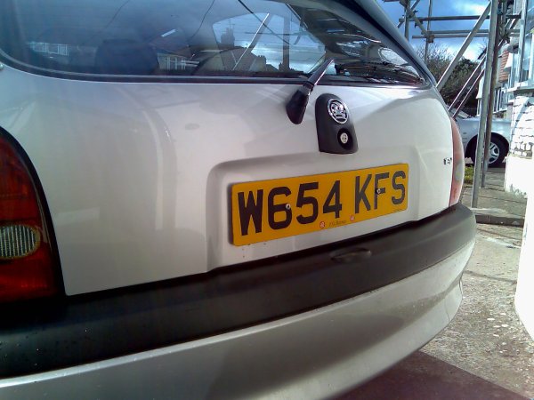

debadging the boot, smooth and spotless, not a clue to suggest there was a badge, wish car was like that all round

i wanted to remove the logo aswel, but dont want to leave a hole tho. i have an irmscher badge on the back aswel underneath corsa 1.4 do you reckon i shud take that off aswel or leave it on.

urs looks smart there m8, is there deifnately a hole under the vauxhall badge coz thats the one i want to remove the most
heres a pic
