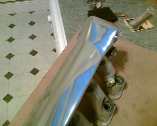

Best way is to use a sandpaper flap wheel to take off all the cast finish. Then basically work through every possible grade until all the previous marks are out. I then used a proper metal polishing kit with supercut polish bar and then colour bar to finish.
Here are some pics
The finish wasnt super as i missed out 500 and 600 grade so i have taken it back to 500 to rework it.
It a fair bit of time to do it all. Also did the outer rims on my wheels but as they werent coated they soon got messy again.
