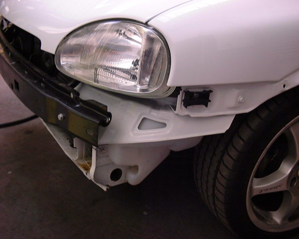

Ive recently had a quote from vauxhall on the Irmscher Airdam front bumper and the guy who emailed me back said this bumper is not suitable for cars with air con, and my corsa sport has air con.
why isnt it suitable and couldnt i just rip out my air con, also since i bought the car ive never once used it, so would it really matter?

i THINK part of the aircon system gets in the way of the foglight on the airdam, it is posible to fit it though

No no
The aircon means the washer bottle is in a different place.
The washer bottle gets in the way of the near side fog light.
Solution - move the bottle.

was just about to say ask ian he did it on his postert fog lamps say the same thing my washer bottle fits fine with the lamps

ive got an air dam and air con, all fits fine, not had car long but fogs arent wired up so dunno if the air con will prevent me from wiring them up but ill be givin it a go
