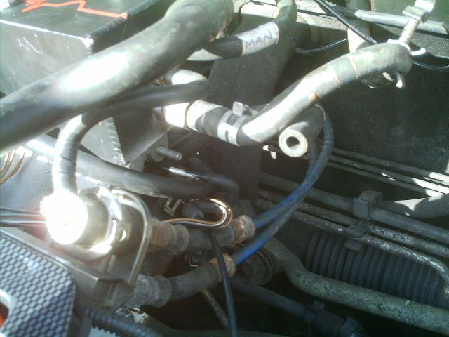

im unsure of where to connect one of the coolant hoses i have here.
there is a large hose running from the centre of the car, although im unsure where it runs from.
this then splits into 2.
one end connects up to the lower manifold to this connection...
thats from an astra's x14xe lower inlet, but the connection is same as corsa.
so, i am unsure of where the 2nd hose connects too?
its this one....
anyone got any ideas please

does that not connect onto the throttle position sensor thats where it would be if it were a corsa engine bay
CoastalCorsa
Registered: 7th Jan 05
15th Feb 06 at 16:08   View User's Profile U2U Member Reply With Quote
yeah on ma corsa it splits off one goes to heater matrix and othe goes to throttle position housing then the pipe returns from throttle position housing to the header tank

right, there are to connecting points on the corsa tb.
this hose that i have referred too, does it connect onto the tb. then from the tbs other connection, will that go to the water tank?

Does the engine have an aftermarket inlet?
From the picture it looks that way. If so, one goes to the throttle body, and then there should be one from the throttle body to the water tank.
johnscorsaXE
Registered: 14th Sep 04
Location: Walsall
15th Feb 06 at 18:36   View User's Profile U2U Member Reply With Quote
all sorted.
thanks for the replies
