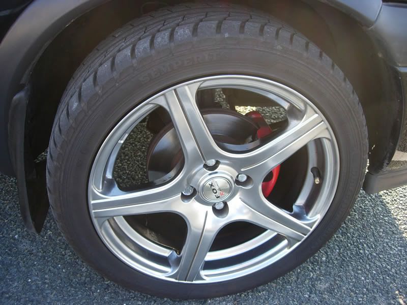

http://i49.photobucket.com/albums/f286/craig_lewis/mycar1.jpg
i am bid'in on some gmax 40mm springs and will be lowering my car over the weekend hopefully any arch work needed ???

17's? correct offset?
if theyre et 49-45 40mm should be fine matey

are they i thought they were ok what make is decent and not over priced
they are 16's and the correct offset

are you sure their the correct offset?

yeah ... the guy who had 2 car b4 me said they were any ways .. when theres a full car and i go over a bump the wheels rub

dont look it from the first picture at all.

take a wheel off and look on the inside of it,it should have ET:XX stamped on there somewhere,should be 49 for a corsa
