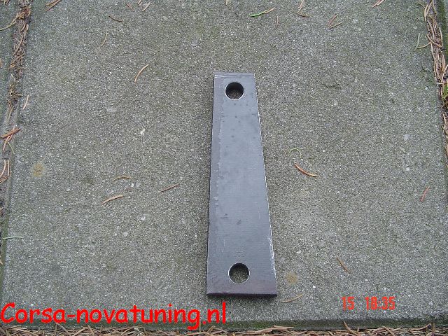

25th Jan 06 at 12:46   View User's Profile U2U Member Reply With Quote
dutch c20xe corsa-b guide:
http://www.corsa-novatuning.nl/nl/PartsB.htm
they also show the gearmount spacer:
12mm spacer (req longer bolts though)

the mtec spacer is simular to the one i posted..
shortshifter can however be an arse to centralize
