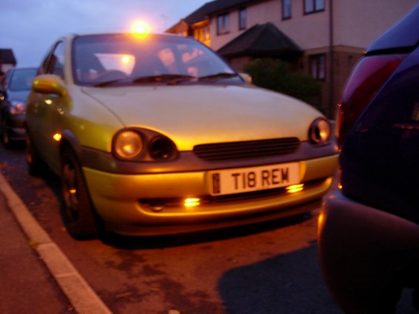

if i was to buy some morrettes without the indicators can i attach some side repeaters instead?

yes, there is a pic on here sumwhere of that.
9th Jan 06 at 16:15   View Garage View User's Profile U2U Member Reply With Quote
yes you can, broster is telling me otherwise, but its been done before, so yes

i have it done on mines'
9th Jan 06 at 17:42   View Garage View User's Profile U2U Member Reply With Quote
so you have!! are they astra g repeaters

should be just a matter of linking off the origional indicator wiring thing
9th Jan 06 at 17:46   View Garage View User's Profile U2U Member Reply With Quote
Yeah they're Astra G.
Personally I would sink something in to the main beam unit. There's bound to be something suitable in the scrappy that you can either paint or get a proper orange bulb for whatever mount you find.

is it right that you have to leave the morrette indicators connected up, and run front indicators off the side repeaters, to stop them from flashing like mad
The total wattage has to be similar, or you can change the relay. Leaving both lights wired up is completely unnecessary.
