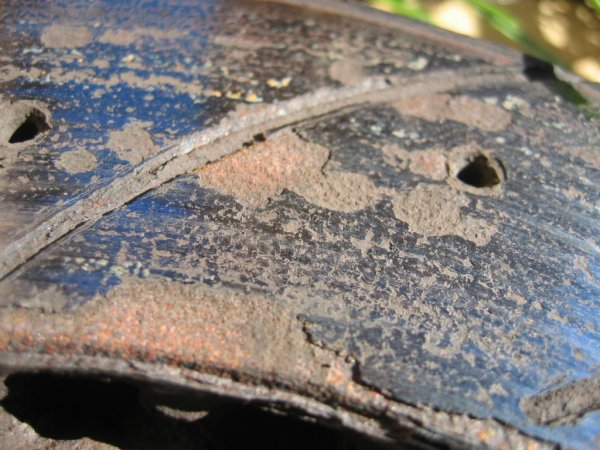

i had this problem with a set of black diamond discs.... this was the problem....
check the inside of the discs!

mark thats pretty fecking horendous there looks like you got a chizzle out to them
broster
Registered: 6th Dec 02
Location: Drives: E39
20th Dec 05 at 09:16   View Garage View User's Profile U2U Member Reply With Quote
i think someone did lol!
