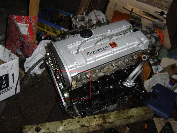

Mine is doing this aswell. Where is the coolent temp sensor located?

where the fcuk is that?!

just on the left hand side of the head, near the front, well it is on my C16XE

22nd Nov 05 at 16:32   View User's Profile U2U Member Reply With Quote
When the engine is assembled the thermostat is here - the thing with the wires coming out of it is the coolent temp sensor.
