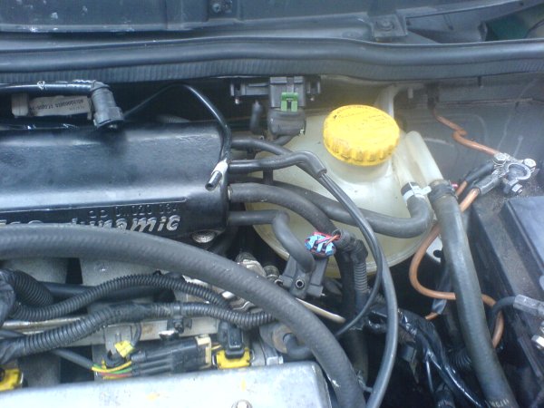

Hi guys right fited the new ECU and transponder this morning , car is now cranking i can see the bottom pulley turning, i currently have no alternator belt as im waiting for a tensioner bracket... dont think this would stop it from starting though....Im also waiting on a crankshaft sensor to turn up which is also another reason why i think it isnt starting, however ive been told i need to run a wire from the fuel pump relay that runs down the passenger side over to the thick red/blue on the 1.6 loom can someone just confirm to me i have the right set off wires..
I can see a thick red/blue on these set of wires just want to check there the right ones.
Secondly just wondering where this little hose goes ... i know the one furthest to the left is the brake servo hose the little one is the one im not sure about shown in the picture..
There is also a hole on the little box just next to it im not sure if anything is ment to plug into there if anyone can enlighten me

that hose (im guessing you mean the one with the white tape on) goes to the carbon canister thingy in the wing, and needs connecting to a vacuum somewhere. so probaly the bit where you thought.

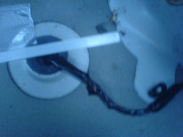

is that a picture of the fuel pump under the seat? dont think you need to connect there, need to connect before the relay, which are behind the passenger kick panel.
the car wont start without a crank position sensor, as effectively the ECU doesnt know that the engine is turning, and doesnt send the sparks, and also if you havent got the wiring to the fuel pump complete it wont be getting fuel either.

Ok cheers mate, i just wanted to locate the rellay to follow it down to the passenger kick panel as you say, and the crankshaft sensor shall be coming tomorrow, so i hopefully want to get everything else sorted today apart from that... so far ive matched up wires

On the 1.6 loom i have blue which is temp and tellow brown is for diognostics so there not improtant atm .... The one that i believe i need to wire up to the fuel pump relay is the thick red/blue...

the red/blue from the 1.2 leave alone, connect the red/blue from the 1.6 into the fuse box on fuse 26. to try it just push the wire in with the fuse as a temporary fix

I take it 26 is for the fuel pump relay then ? and i have the 1.2 plug and 1.6 plugs in my drivers footwell close to each other.....

id guess fuse 26 is fuel pump. i read it off haynes wiring diagram though

8th Nov 05 at 13:27   View User's Profile U2U Member Reply With Quote
just remembered on mine i just blocked up the little hose to the charcoal canister. seems to work alright

Originally posted by Rob B
the little hose with the white on it as mentioned, what does it do? mines there and not connected to anything! what is it for?

pipe inm the pic is from the caharcoal cannister. connect it to the valve.

Originally posted by corsa808
still not got it sorted after our chat?

Ive got a crankshaft sensor now dude fitted it this morning im just trying to work out how to wire up the fuel pump to the 1.6 loom now
EDIT: i know off the 1.6 loom its the thick red/blue and have been told to wire it straight into the red/blue comingfrom the fuel pump...
But ive also been told to do something with a brown/red wire off the 1.2 loom which i was told to connect it up to the fuel pump relay on the 1.6 which i can see a brown/red wire...
