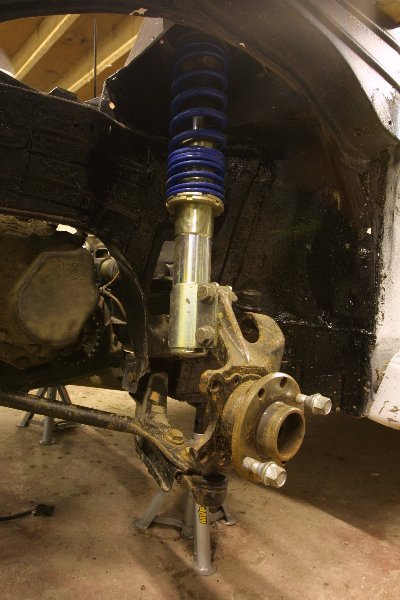

was just out looking at the girlfriends tigra there she has the car about a year... was looking at the suspension and noticed something that doesnt look right to me at all see if you can spot what i'm on about...

no tie bar (if thats what its called) from ball joint to front bit somewhere

yea there is...

lower arm appears to be upside down to me...?

28th Oct 05 at 17:18   View Garage View User's Profile U2U Member Reply With Quote
pretty sure thats hopw mine was :S cant rememeber 2bh tho

nah it is correct, u wouldnt b able 2 get on the nuts that hold tie bar on otherwise ?

i know the corsa ones changed in 1997 maybe thats why its like that... but on the corsa the lower arm would be on the other side of the car and the other way around.... the tie bar sits on top of it not underneath like in the pic

Tie bar is upside down - do you have a matching one on the other side?

Corsa one -
yeah!....its the lower arm tooo... the holes in it should be on the bottom and the bolts are upside down town.... its like someone had them out to do the bushes or something and just put the whole thing together wrong
have to say the car handles like its on rails... wonder if this has anything to do with it?
cant believe i didnt spot this when i was installed a bilstein kit on her car
the apprentice must have got at it...
