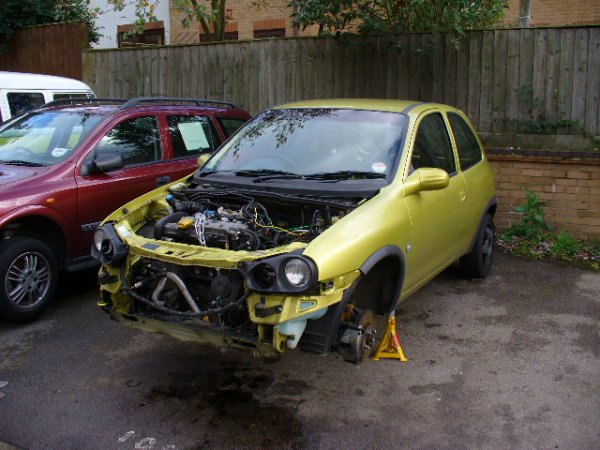

2 days into the engine swap, and this is all i've managed to do so far, still waiting on bits from vauxhall and pipercross ( joff) so i can properly get going
my car now looks hard
and has no central locking!
[Edited on 25-10-2005 by robmarriott]

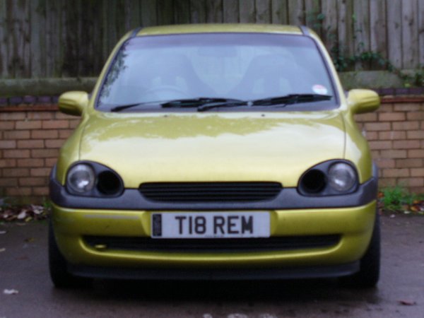

what are thos headlights u have called?
Jason Iles
25th Oct 05 at 10:09   View User's Profile U2U Member Reply With Quote
Someones nicked your side lights
25th Oct 05 at 10:10   View Garage View User's Profile U2U Member Reply With Quote
morettes, or twin headlights, i've removed the inner main beam lense (outer does dip, main and sidelights)

Is it just me, or does taking those inner lenses out make the car look cross-eyed?

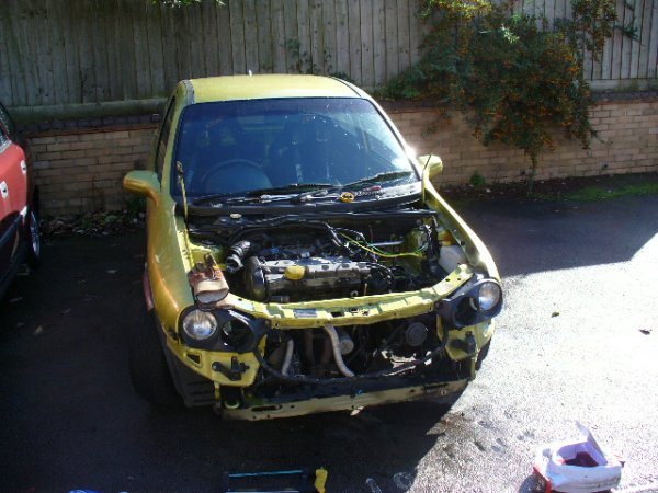

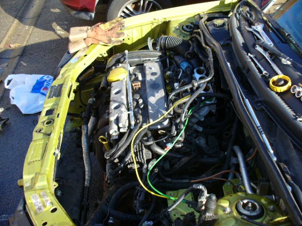

this afternoons progress.....
now a bit stuck as we need a 30mm socket for the castle nut on the driveshafts....
it will be out tomorrow... extreme lightness!!!

y do u need to undo the castle nuts? or are you swapping dirveshafts as well?
25th Oct 05 at 14:39   View Garage View User's Profile U2U Member Reply With Quote
cant get the shafts out of the box without doing so, or so mr haynes says

you can, cos i did

how do you do it then? cos that would save ne time

im assuming u have taken off the anti roll bar? so the bottom of the suspension strut is free to move about. theres enough play in it to pop the shafts out
i tied them up level-ish again after id removed the engine tho, to relieve stress on the cv's and bearings etc
25th Oct 05 at 15:03   View Garage View User's Profile U2U Member Reply With Quote
certainly have, will try your method in the morning!! cheers for the help rob

As robhayes says loosen off the strut and yank it out
