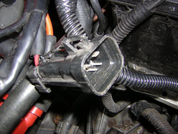

I guess red and black wires can just go onto the battery? What do i do with the others?

what colours are they???? what car did your engine come from ?

Came from an astra gsi. can't remember the colours, i'll check when i get home.

Blue red - fuel pump
Green - rev gauge
Blue - coolant temp gauge
black- switched live
brown blue - maybe ecu light
basically match the ones on the point where the old 16xe ecu used to plug in, and you'll be fine.

So i've gotta route them back into the drivers footwell?

what about the red one?
