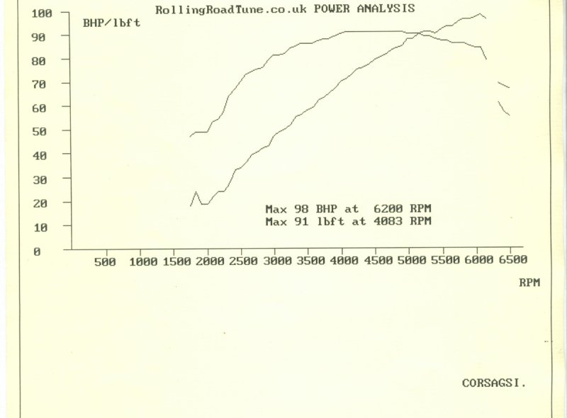

Not sure whether i'm pleased about the results or not...its about what i expected...but secretely i guess i wanted more!
So heres the graphs.....firstly the one i did about 6 months ago, then the one i did today:
Standard X16XE - The first run actually came out at 100 Bhp but then he lost the data...!
Modified X16XE - dbilas inlet, sebring exhaust system from cat back.
some people reckon it may be under-reading?? what do you think?...

Forget the figures, just remember you have a 25% max power increase and 11% max torque increase! And it's not top endy either. Nice one.

even if it is under / over reading, you have used the same RR, and providing one day was not 30degrees and the other 5degrees in Temp, you have a good comparison!

looks fine. was done on the same RR. nice increase. dbilas inlet has always been one of the best
